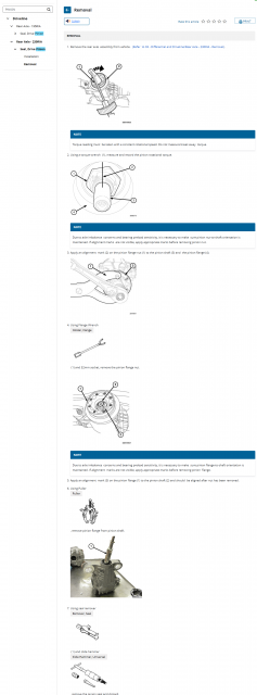

So I did find this documentation on the pinion flange removal and installation to repair the seal. This helps me with re-assembling that, however I didn't mark any orientation as I was cleaning out metal so that was more of a priority. I wonder if imbalance will occur. However if you install this into a billet housing there's no way to keep track of that so, by reasoning maybe its a herring???
this is for re-assembly
My mind boggles at this:
"If the pinion nut alignment index mark exceeds the pinion shaft alignment index mark the unit must be discarded. If the pinion nut alignment index mark falls short of the pinion shaft alignment index mark the unit will possibly generate an Noise, Vibration, or Harshness (NVH) concern."
Knowing this I would have just bought a billet case and said screw it with these housings. However I don't think this will be an issue, we shall see.
so let me get this straight. They’re marked from the factory (maybe), and if you can’t see the mark on the pinion flange and the nut, you’re supposed to make your own index mark before disassembly to mimic factory “torque”. Is there no set torque spec for these??? Blows my mind too. I guess that’s how they get around telling you the torque specs? Then again they also tell you to index the driveshaft before you take it out I haven’t done that and I’m fine, maybe I get lucky but that doesn’t have anything to do with torque indication like this index mark would

Calling in the big dogs @Hatermkr do you have any torque values for the pinion flange nut?
there is no torque for the nut, you tighten the nut till you achieve bearing pre load. tighten in small amounts till achieved. do you have the spec for pre load cause I couldn`t find it anywhere but I had no reason to take my flange off when I did my wave track. brgs. felt smooth with no end play.
