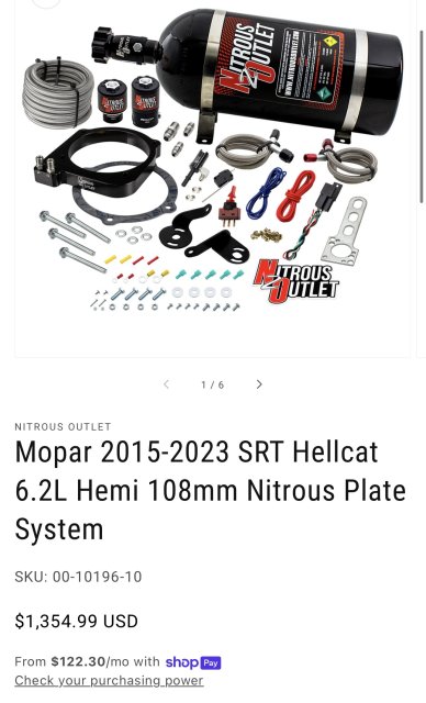

Hellcat is being resurrected for October 5th event. Does anyone know of a nitrous plate for Kong Throttle bodies? 108mm in diameter.

Hmm, I guess they're still 105mm inside
8,506
7,433
HHP has the plate for $270
Superior Atomization. This injection plate has 6 specially designed nitrous and fuel discharge ports that completely saturate the air intake charge with the best atomized mixture possible. For higher horsepower levels proper distribution into the air stream is critical for cylinder to cylinder distribution.
Quality Construction. All Nitrous Outlet injection plates are machined from billet aluminum, have a black anodized finish, and CNC engraving. All plates are flow tested to insure proper function and flow characteristics.
Complete Conversion. This plate conversion kit includes all needed hardware and jetting to convert a single nozzle wet system to a plate system.
Application. This plate is designed to fit the 6.2L SRT HEMI Hellcat with a Nick Williams 108mm throttle body. This plate will work with any brand wet system and has 3AN inlet fittings for fuel and nitrous
  • Flow Up To 400HP
  • 105mm Billet Aluminum Plate
  • Fits Nick Williams 108mm Throttle Bodies WP108TB-HC-BLK or WP108TB-HC
  • All Hardware, Gaskets, and Jetting Included
  • Precision Atomization
  • Jetting Included For 50-100-150-200 HP

I'd call them and double check, seems odd they would market it as 108mm but list 105mm

If you read on HHPs site it says it's 108mm. Man, now you have me thinking about nitrous again lol

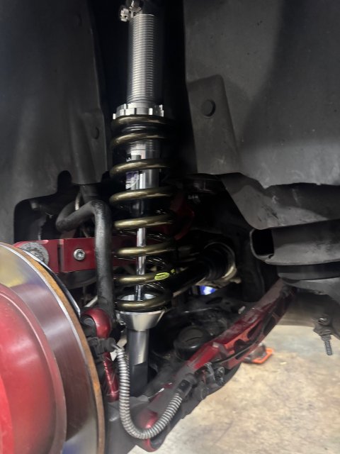

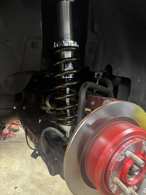

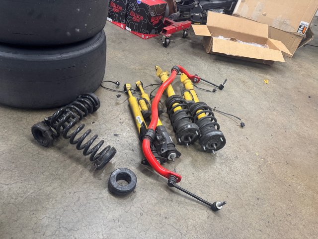

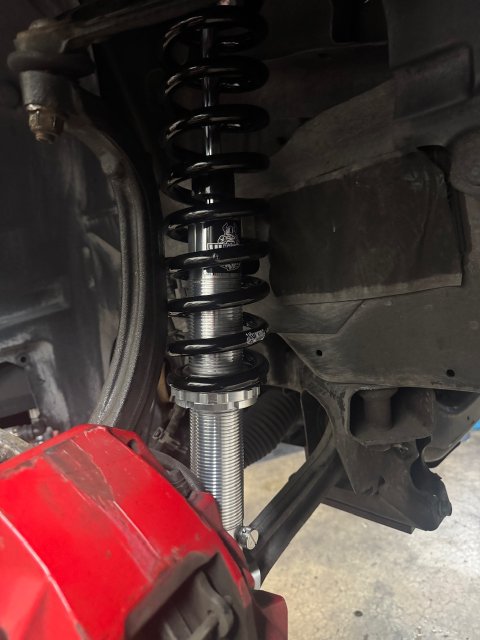

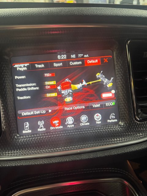

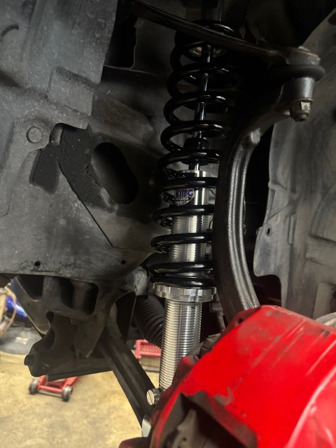

Active Dumping delete. Iykyk 😂
IMG_7759.jpeg IMG_7758.jpeg IMG_7757.jpeg IMG_7756.jpeg IMG_7755.jpeg IMG_7760.jpeg
shout out to @Unholy707 for the refresher on where we take dumps 🤣
