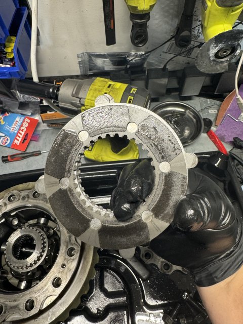

@zhc has a factory freak. Immaculate clutches and steels.
Smooth controlled burn outs with both wheels spinning is the key.
Those clutches burn up real quick when only one wheel spins and you don’t realize it.
One way you can tell you’re only spinning one wheel is your speedometer will be reading much lower, like half or less than expected for the rpm and gear that you’re in

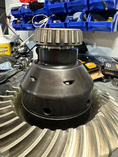

300*F in an oven for an hour, slid right on.
300* in an oven, stopped half way, pissed me the fuck off.
improvised and cut an old bearing open, ground out some of the interior and used mechanical persuasion
final assembly tomorrow (shims, final ring gear torque, housing assembly)

I wonder if you froze the entire carrier to contract it and heater the bearing to expand it would have worked. I had to throw my pilot bushing for crank in freezer overnight, then slid right in
