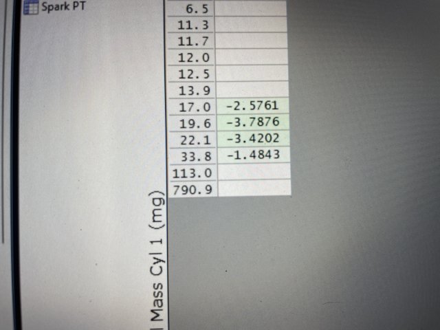

Dropped in some new injectors thanks to @Jon-MooredPerformanceLLC its interesting to see that FIC data uses the whole table where ID does not. The Inj PW vs FM data is wonky but after a couple of idle sessions and some street driving I’m sure it will be fine.
0716C42D-B22E-4A61-BA41-34E7E1B9632F.jpeg C873C901-ABD3-437D-9B72-6B4FD336CB1B.jpeg 6916EC1D-F653-40AC-BF6D-32B24C744E7C.jpeg
I do have to say I like the construction of the FICs more than the ID, but like the ID data better. Also got a new belt and TBA thermostat housing to put on.
View attachment 95968 View attachment 95969 View attachment 95970

Yep I hear the injector data is way better with FIC and they idle way better. Never liked my id1300x2s
id data is way better from the factory but once dialed in at idle for sure they are way better than ID's so far, when I go WOT we will see what they bring to the table soon...
