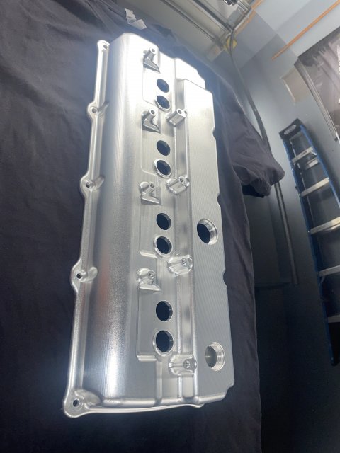

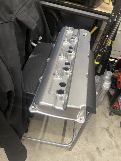

If they're unfinished Al you may consider a clear powder coat so they don't oxidize. Now would be the time to do it.

are those Manton? Can you show inside?

with the amount of racing i do with the car almost every weekend in the summer plugs are a must every year, even checking them will now be infinitely faster.

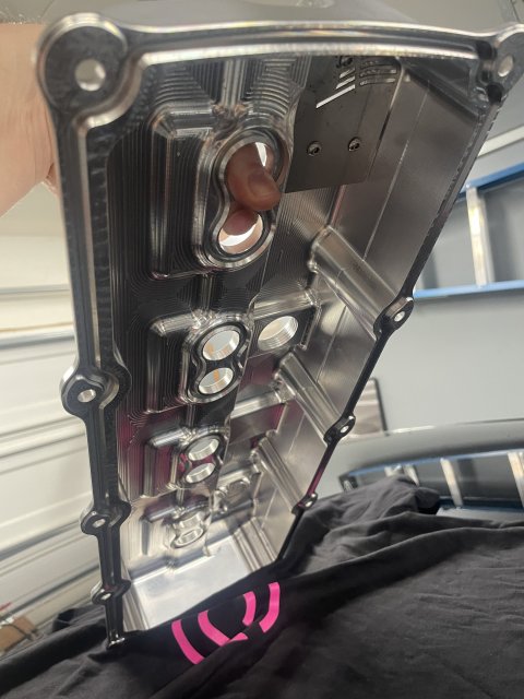

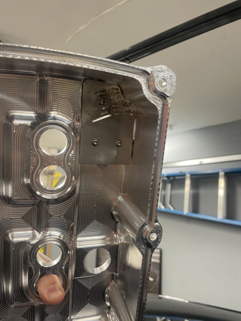

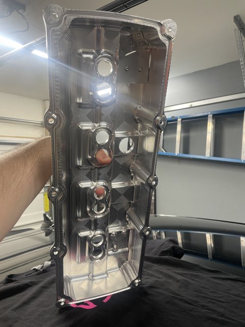

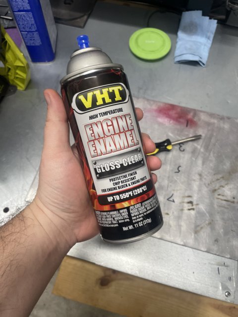

yes manton, i am in the process of clear coating them right now so i will post a pic when done.
1,596
3,977
very nice, thx.

absolutely the most difficult thing and moment of sanity leading me to cut plastics with a cutting wheel with the wires within a millimeter of their life was spark plugs. Fuck that noise. 6.4/5.7 boys have it so easy, the baffles aren't needed, run a catch can or two.

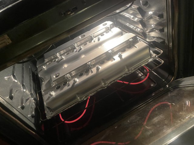

still have two hours before I can chuck em in the oven at 200F for an hour
76AABB10-F5F5-462A-9D62-142C5B250510.jpeg 7F57F347-5D28-46BB-87A0-0DA16D39414C.jpeg EA51B935-BF87-43DD-B7F0-8EB4DEBB6C21.jpeg F3166B07-7DA0-4B7B-8AE2-04BFB8E52D45.jpeg D4949274-7AF6-46FD-83E6-B51C141824BE.jpeg FF6A32D3-DCBB-4E41-B2F3-679AD1B1E18D.jpeg

Who makes those valve covers? Look nice man
