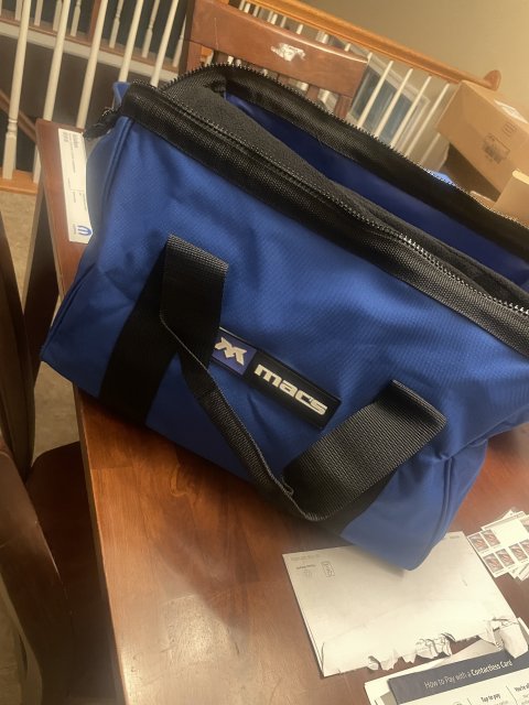

Thread Starter #179
Mmm beefy
F046017A-34AB-45B4-BFAF-BE53F3205B5B.jpeg 598E803C-4E74-49B6-95F3-CBE9EB8746A5.jpeg 1F766654-1022-49A2-9269-D67A0A2D9169.jpeg FB67C060-C513-46D8-9C59-A19AD1728FBB.jpeg

Nice! You sure wouldn't find that at Tractor Supply.
