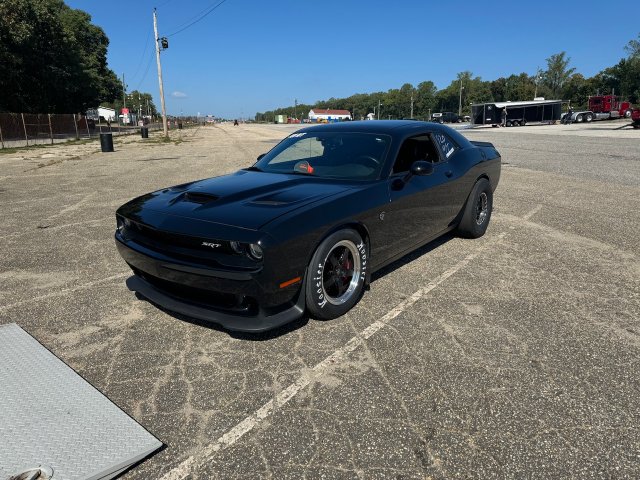

Car is done for 2023. Did a wheelie, broke axles. I’m done for the season. It was fun while it lasted.

Hopefully someone got. Pic of the wheelie! Sorry to hear that man, but wow at least you know the engine is healthy and the wavetrac works!
