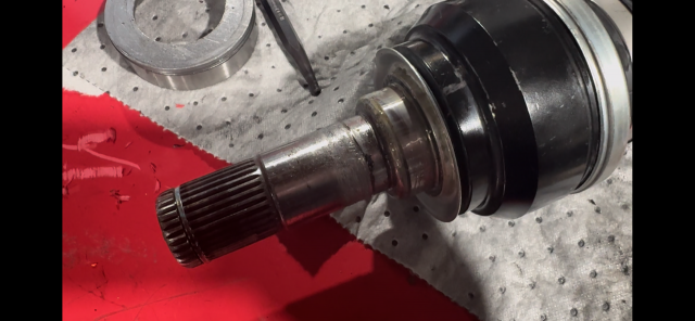

The carrier has been sitting for a few months, I would literally look at it and curse it and just stare at it and walk away. Finally said I need to make room and took it over to Starcks performance as I would need a press to get it out of the carrier. Disassembled the carrier, none of the wavetrac gears or internal components are at fault. The demon axle somehow shredded itself in the carrier then welded itself to the carrier as that's why I couldn't get it out.
it will be shipped out to wavetrac for repairs or placed in the graveyard of 3.09 parts, all based on what HHP or Wavetrac want to help me with.

That’s insane. Any splines twisted?

Wow i somehow missed this post. id be interested to see if either the axle or bearing tolerance were off on either. the splines look good. very odd spot to get seized in the bearing like that? possibly a small piece of debris or something got between them and got it hot enough to lock in there like that.

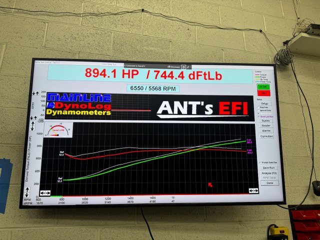

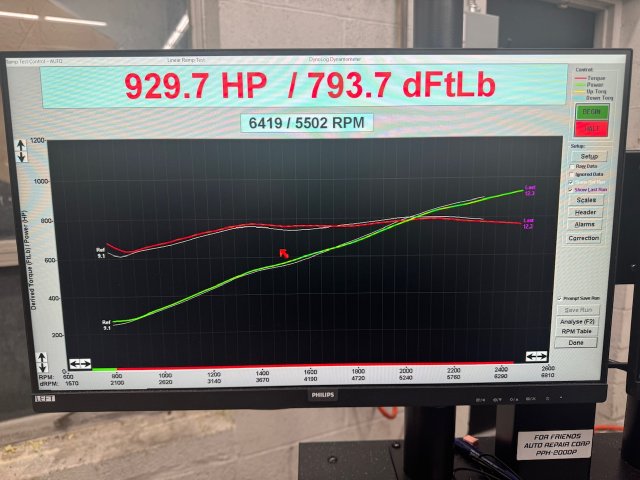

So make it make sense. Last time the car was on the dyno it had 2.70 upper and 10% lower. With this, the car always felt loose, ready to just be a rocketship.
Last night the car was on the dyno as we were trying to slow it down. Went with a 3.0 upper and 10% lower.
Car felt like a freight train but solid, didn’t feel loose but felt deadly.

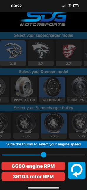

Now if we use SDG’s tool it does not like the 2.7/10% combo. However it does like the 3.0/10% combo.
Its as if removing the heat from the blower negates the psi from having it.

Wow, I had no idea that tool existed. So the less is more theory here
8,508
7,437
Wow, this tool is amazing. Now I know how much I can pulley down
