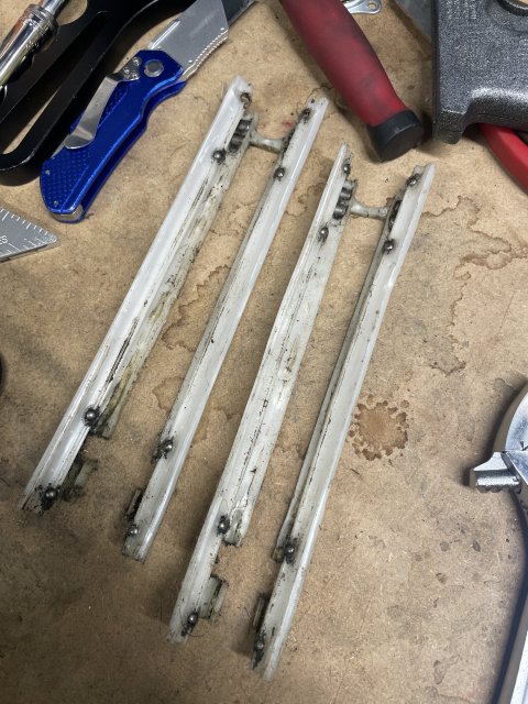

Need help locating the plastic sliders, passenger seat needs to go back in.
dodge doesnt sell these individually, they want you to buy the whole bottom. If anyone has these pleae let me know. These shim in between the sliders and the seat rails.

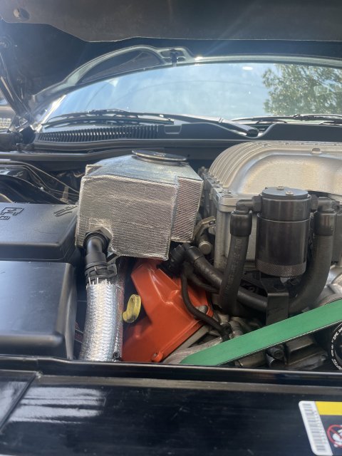

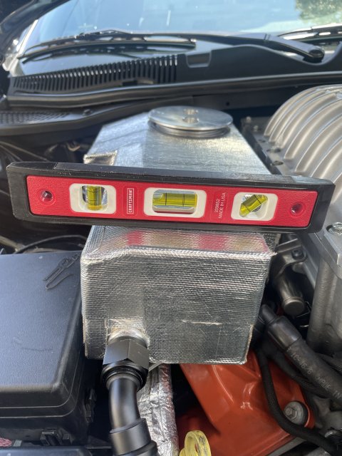

Where are the attachment points for the tank? The engineer in me worries about metal fatigue from vibration.
As time went on with heat cycle and passes the tank began to develop a cant onto the fuel rails. This is a safety no no, fuel rails and fuel are were I draw the line on the car. So the guy that came to view it today and drove it with his wife, didn't wind up taking it. Wife did not enjoy the ride. Oh well, hopefully someone else bites. In the meantime I decided to fab up a mount for underneath the tank.

off the rails now and nice and somewhat even
7,586
19,882
Interesting, wonder if others are having movement.
