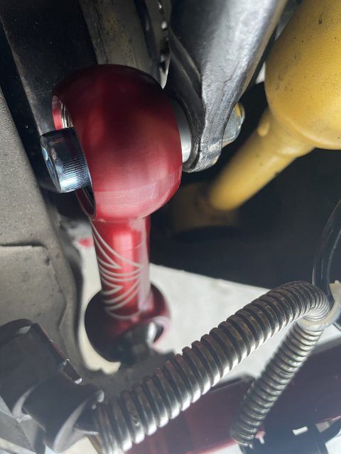

Also forgot to add, went home, took a fucking angle grinder and hatred to the knuckle

Not sure how you didn't hear any grinding then you did. Tells me something changed. Wheels are hitting the arms, or sway bar?
it was the articulation in the sway bar making left turns… anyway those ears are gone… more aad suspension parts…

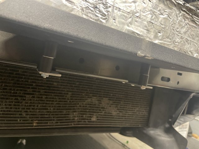

Front mount killer chiller done.
Very happy the existing liquid line worked out to be the right length, have to cut some new ac lines for use but it's late, test fit of the bumper, based on existing measurements of the foam insert it should be fine.
More better like that. I notched out my bumper support to recess the chiller some.
FYI - those curved end pieces on the bumper support can be taken off to save a little more weight, I did with no issues.
