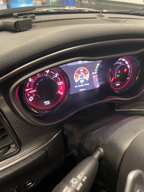

Thread Starter #586
Today at idle with more bubles out it got it down to the 40s with ease. On the way home last night I popped P0EA7. Thought I blew up the pump. No sir, that fluid is still circulating like a champ.
3,795
8,987
Are you running straight water in it or do you have some antifreeze in it? It needs a 30% solution of antifreeze because it’s monitoring the current of the pump motor and if it doesn’t see the proper resistance to spin the impeller (load ) it thinks it’s running dry or it passed an air bubble that’s what the code is meaning something was odd with the pump current

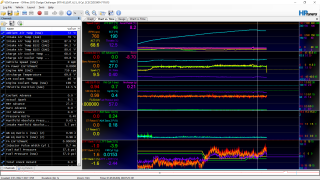

I'm still doing testing and trying to get as much data as possible. The car idled for 2:48 in this first screenshot.
Notice IAT sensors. TL;DR b1s1 is on intake, b1s2 is on snout passed throttle body, b1s3 is on the lid. All higher than ambient as the car is starting to heat up. Take note of the Charge Air Cooler sensors, those are post the bricks, one is in the front and one is in the rear of the super charger. Fast forward to idle still, car has been on for a hot minute, 7:25s in...
As the super charger has gotten hot, the air temps average out to 68.6 still, which means the KillerChiller is doing it's job as the post brick temperature is cool going into the engine. Still going to test and look forward to hitting the track tomorrow night. Also the KC frosted up on the outside, it was getting stupid cold.
