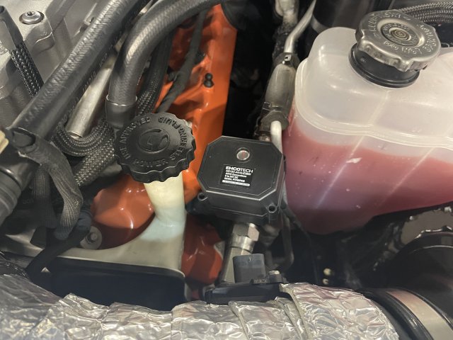

D76672C9-1131-4EA7-ADF9-41108B170B90.jpeg 57EF7892-F50E-4120-8C59-14667B75A024.jpeg
however drag valve is in.
Good job. Was there a need for a dielectric unions?? Different metals. Looks good.
4,130
10,402
Thread Starter #576
Potentially, I think the valve is made of aluminum with AN fittings where the Tee and AN fittings for the AC lines are steel.
Yes could be a concern. Have copper for refrigerant, steel for gas, and brass for bypass. PVC never hurt any one. If you see the green on the threads, then you know what to do. I was going to buy you a plotter for Easter but seems you took care of that.
