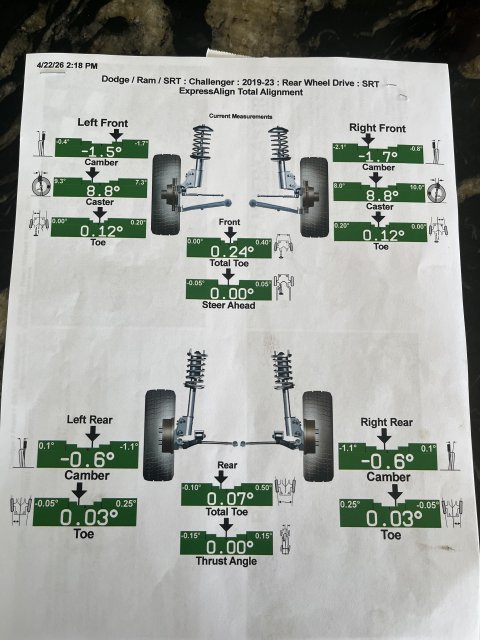

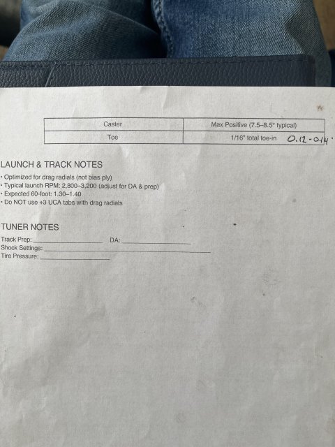

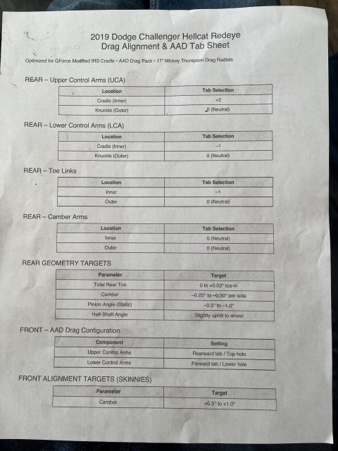

If someone could provide a link or direct me to a post with alignment specs I would appreciate it.
Thanks
3,643
11,761
Factory specs in the front. Positive camber in the rear. I ended up with +2 degrees. Ran 1.25 sixty with that on a 315/60R15 Radial Pro. Key to straight line stability is zero toe in the rear. Make sure that if there's any error, it's to the inside.

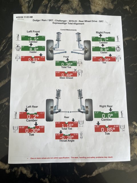

So I actually found specs that are supposed to be “optimal “ for my Gforce modified cradle set up and I had my car aligned today. Everything seemed to work out fine other than a possible u-joint that is failing and the likely suspect for the noise I was hearing. So for what they cost I am just going to replace the u-joints and hopefully that issue will be solved, but you never know. IMG_7940.jpeg IMG_7941.jpeg IMG_7936.jpeg IMG_7937.jpeg

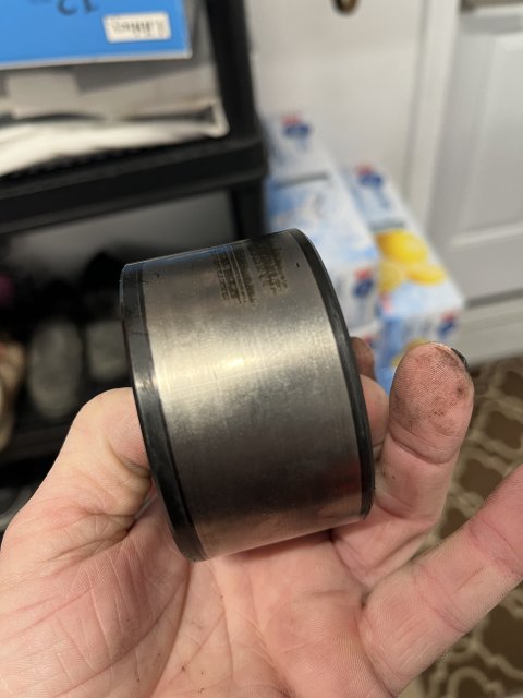

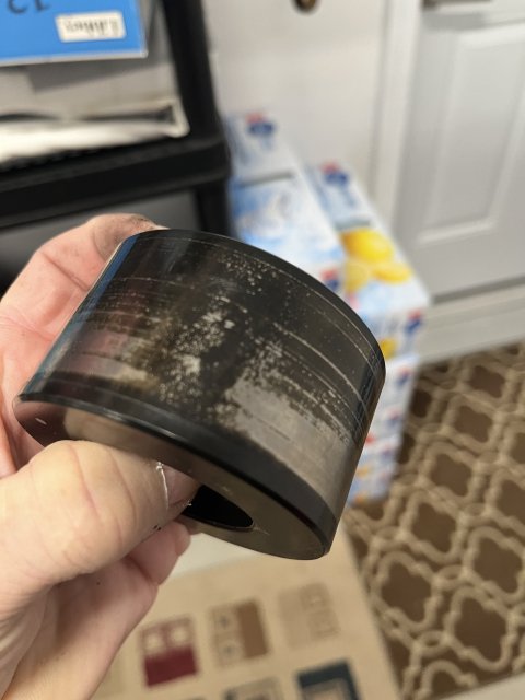

So I decided to replace the tensioner and idler pulley with the Metco product as I did notice that although the bearings seemed ok it was visibly obvious that the belt had been slipping on the pulley as seen by the pictures below

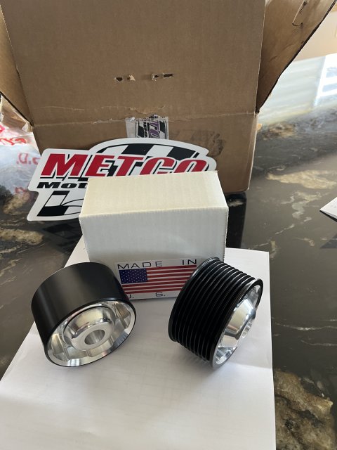

The Metco pulleys not only looked a lot nicer they were considerably lighter. IMG_7974.jpeg
