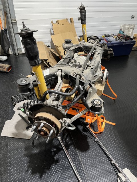

First off I will say i am not a mechanic but I do have decent mechanical aptitude and this project although not huge, is the most extensive automotive modification I have ever made. It’s fairly straightforward if you take your time and I would give it a 5 or 6 out of 10 on the difficulty scale, so it’s fairly easy but I personally would not want to do it without a hoist.

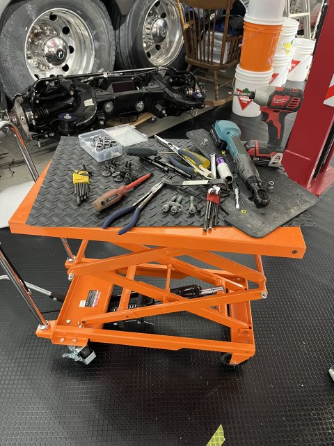

I also bought a hydraulic lift table from Vevor that was extremely handy, it was rated for 550lbs and had a lift height of 48”. It worked perfectly for removing the original cradle and installing the modified one. It also made a great tool cart and will be very handy for loading stuff in and out of my pickup truck.

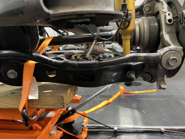

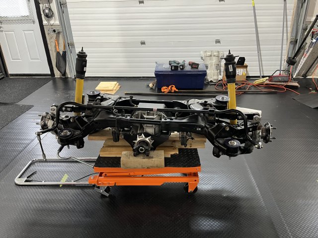

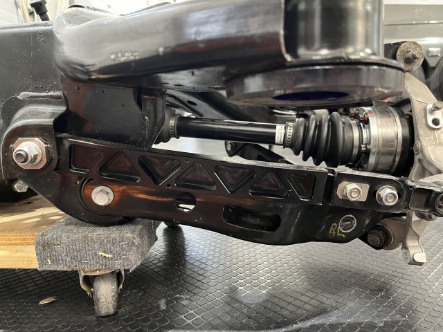

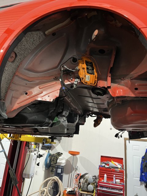

The point of no return.

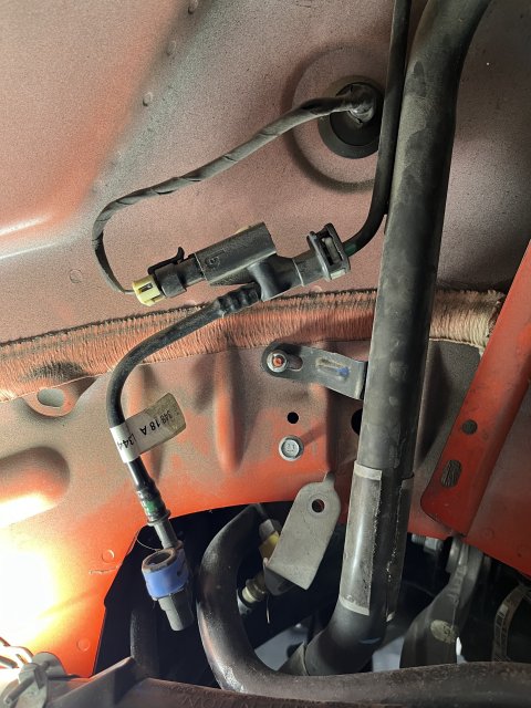

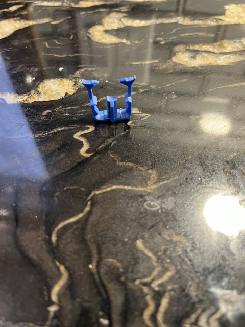

I broke a plastic clip that hold part of the fuel line system together and hopefully can get a replacement. I tried to crazy glue it but it didn’t hold. IMG_7538.jpeg IMG_7555.jpeg IMG_7556.jpeg

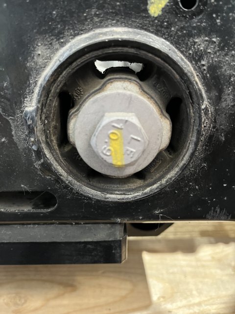

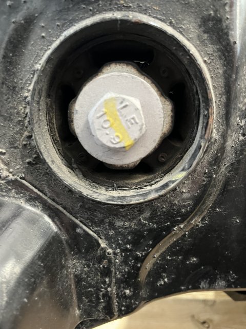

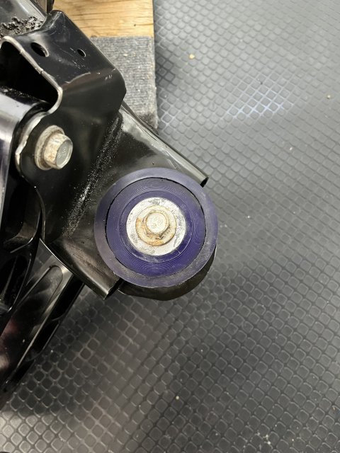

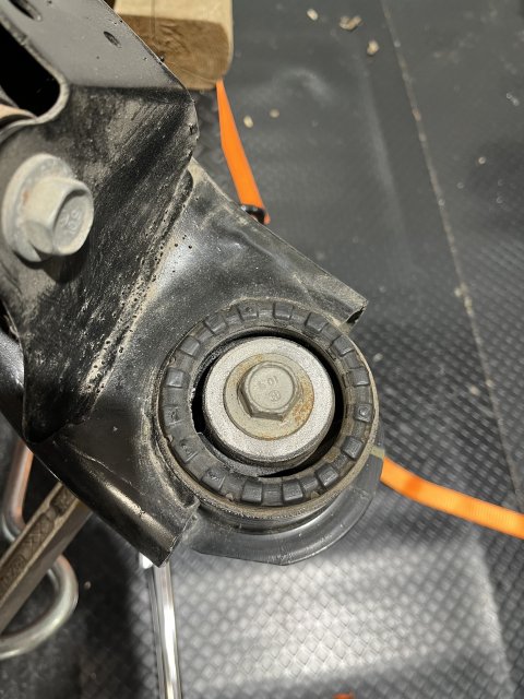

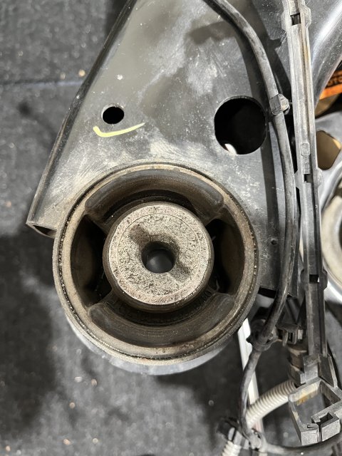

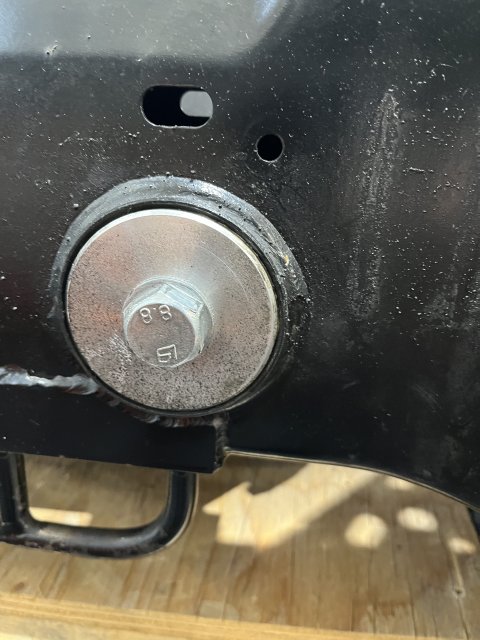

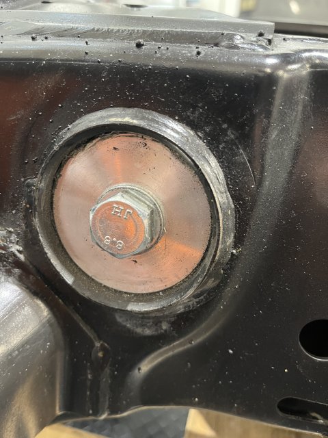

Here are a few pictures that show the stock cradle bushings compared to the modified cradle bushings.

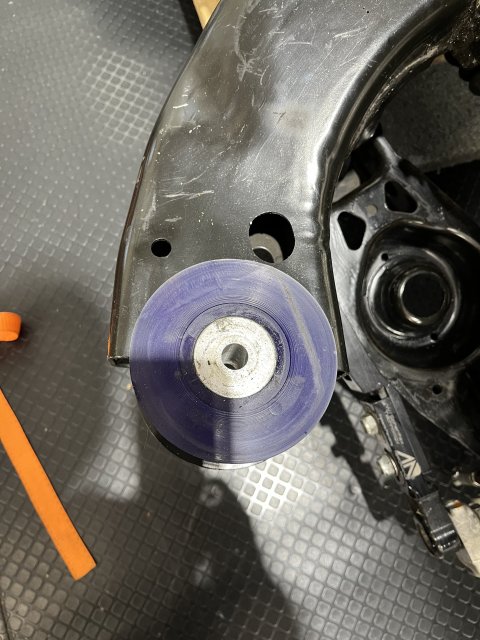

And the stock differential bushings compared to the modified ones.

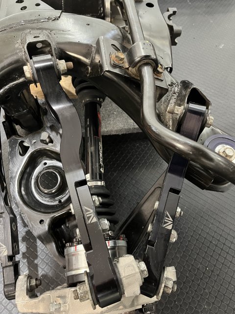

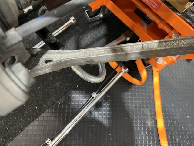

Here are some pictures of the stock parts compared to their AAD replacements.
IMG_7570.jpeg IMG_7571.jpeg IMG_7572.jpeg IMG_7573.jpeg IMG_7574.jpeg IMG_7575.jpeg IMG_7577.jpeg IMG_7576.jpeg IMG_7579.jpeg IMG_7578.jpeg

I broke a plastic clip that hold part of the fuel line system together and hopefully can get a replacement. I tried to crazy glue it but it didn’t hold. View attachment 175922 View attachment 175923 View attachment 175924
I went into town yesterday to pick up a few things and stopped in at the Chrysler dealership to see about replacing this little blue plastic clip I broke and as I suspected they don’t sell it separately. It comes with the full “assembly” which can be purchased for $150.00. I tried searching the internet for something aftermarket but didn’t have much luck. Amazon did have something similar that I might have to order and try for $15.00 just for the clip.
If anyone knows where I could find this clip please let me know.
Thanks.
06SRT10NR
#1148
1,645
2,748
Knobnation
#71
Thanks.
won't say you'll find it, but I've had soime luck in the past here:
https://www.clipsandfasteners.com/Default.asp

2ndgen
#1309
426
688
Orem
#73
is this it?
There's more info and more part numbers in that thread.

I think I found the clip I need on Alibaba. I will find out in a couple of weeks when it shows up. IMG_8272.png IMG_8272.png

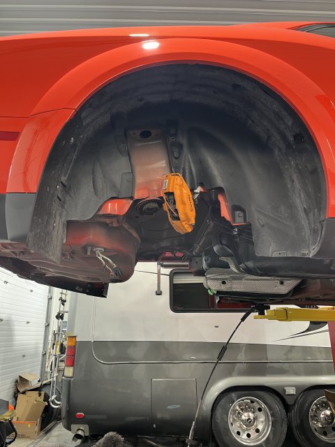

I’m not sure of the “proper” procedure for aligning the cradle when reinstalling but I hung a plumb bob from each side of the car and measured to the centre of the axel stub then also measured from the centre of the axel stub forward to the same point on the car on both sides.
I managed to get the cradle cantered both side to side and front to back within 1/16” or 1/32” per side so that should be good enough and I will be getting an alignment done anyways in the spring.

#76
Sounds like that could work.
When I reinstalled mine I measured with a tape from the rear bumper support on each side. I should probably get it aligned just to be sure, but it tracks straight as far as I can tell.

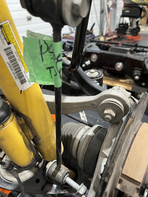

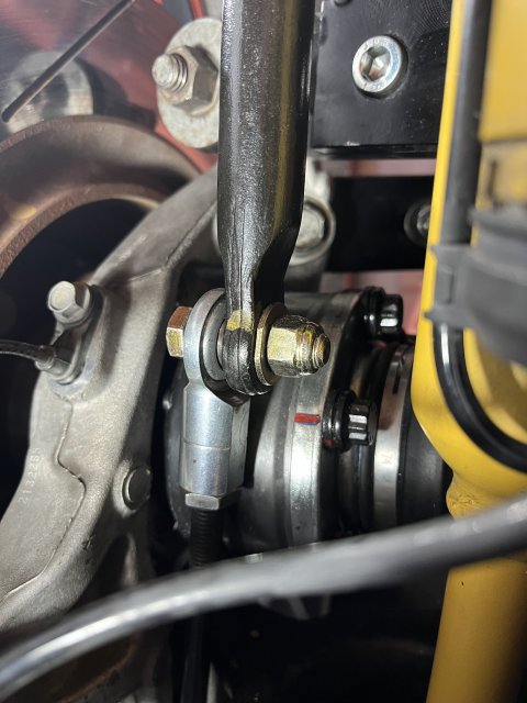

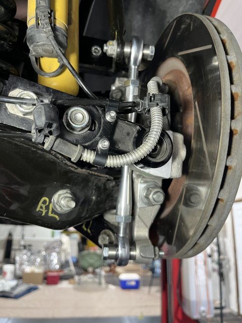

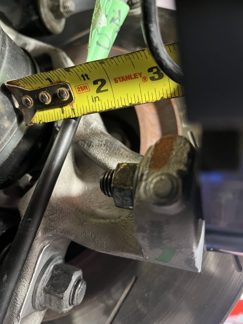

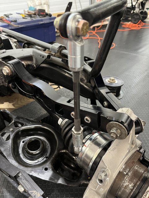

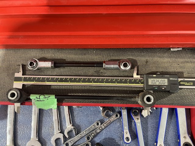

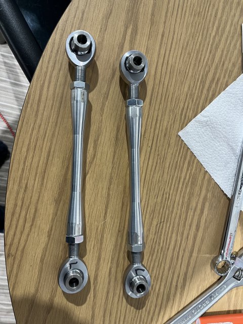

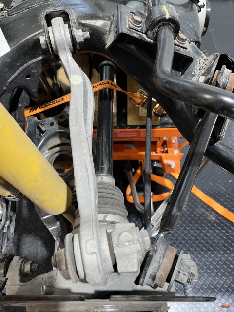

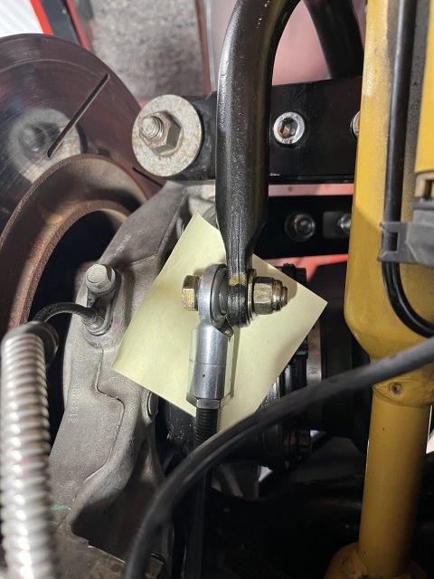

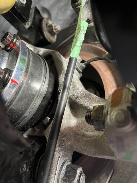

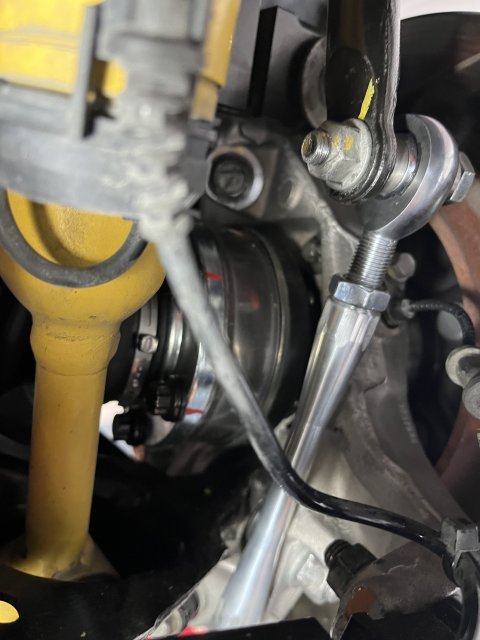

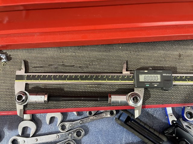

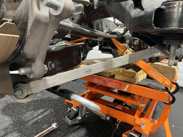

IMG_7632.jpeg IMG_7631.jpeg IMG_7633.jpeg IMG_7636.jpeg IMG_7640.jpeg IMG_7641.jpeg Can anyone tell me the centre to centre distance on a shortened rear sway bar end link ? The cradle I bought was being run with 15” wheels and tires so needed shortened end links and has a pair of adjustable ones that are set 8” centre to centre where as my stock Redeye ones are 10.25” centre to centre. When the shortened end link is installed there is basically no clearance between it and the axel, I can barely slide a piece of paper in which is oo3”, where the stock end link has a little over 1” of clearance. So I was just wondering if anyone had the centre to centre distance on shortened links they are running ?
3,639
11,743
#78
AAD has billet end links that relocate the attachment points on the spindle that allow you to cut off the factory part that has the clearance issues with a 15” wheel. It will probably fix your axle clearance problem. Talk to them.

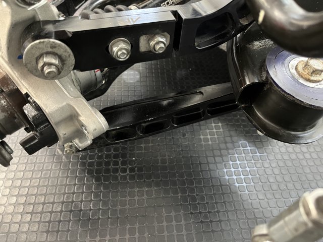

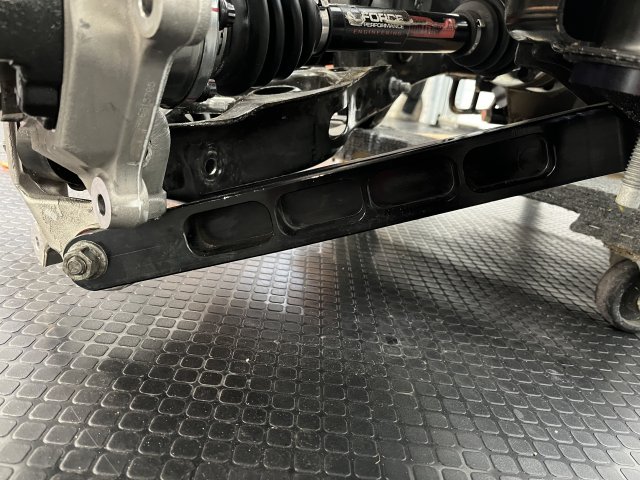

So the rear sway bar end links that came with this set up just seemed too short to me and didn’t allow enough clearance for my liking. Way back in the beginning of this thread I posted a picture showing where the sway bar had been hitting the AAD arms as well, so I went ahead and ordered some new ones.The AAD rear links looked really nice, although they weren’t adjustable and they were kind of pricey in my opinion. So I ordered a set I found on High Horse Performance that looked nice and were less expensive
They look like they should work.
