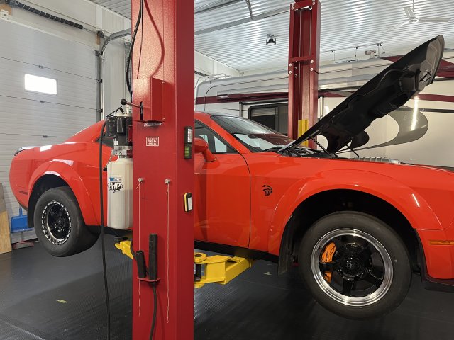

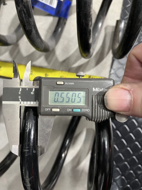

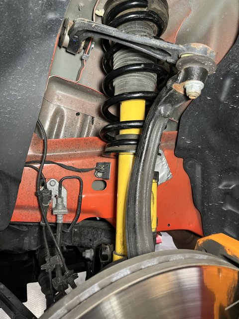

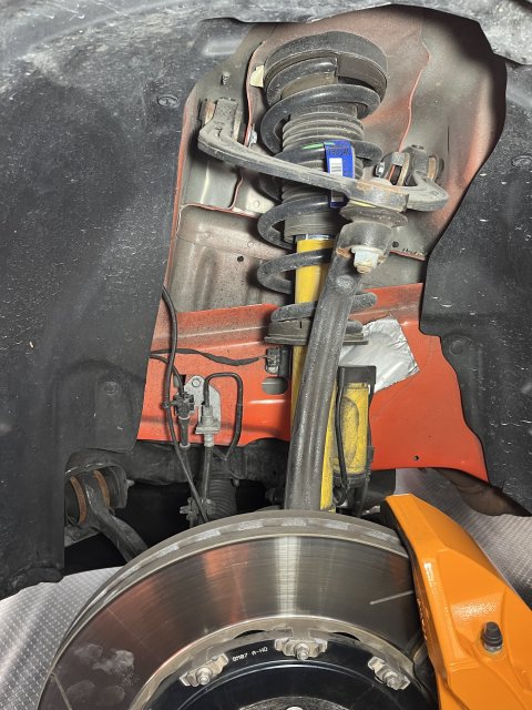

Changed out the front springs the other day to the “Demon Killer” springs I got with the used suspension package IMG_7730.jpeg IMG_7731.jpeg IMG_7733.jpeg i. They are actually from Dusterhoff Racing so maybe demon killer springs are different?
They are definitely taller than the stock Redeye springs and also a smaller diameter.

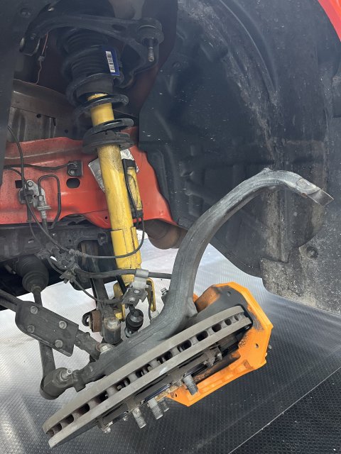

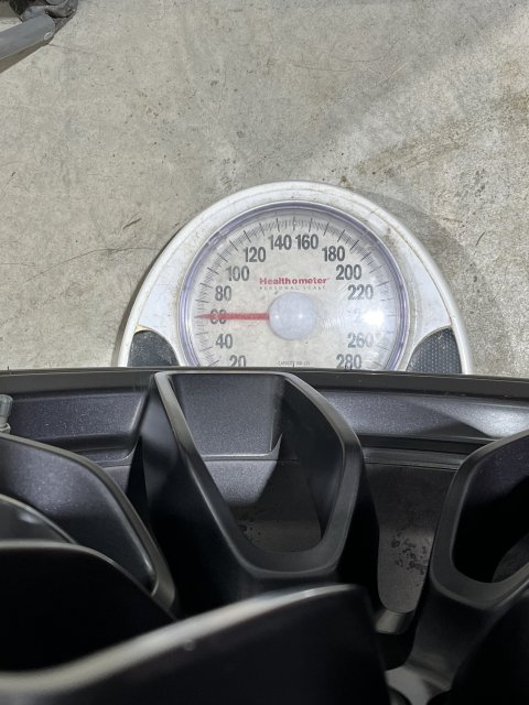

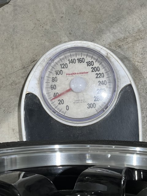

I also checked the weight of my front skinny compared to the stock wheel and rubber.

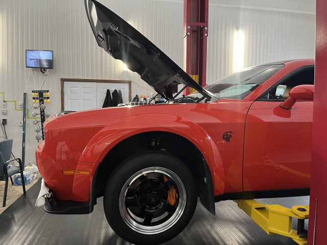

So the weather is finally turning here and we are in the April showers season. The weather still sucks but at least the salt is getting washed off the roads.
I will be taking the car in for an alignment in the next couple of weeks and wondered what the alignment specs I should be shooting for are ?
I know I read some posts on here weeks ago with that information but I can’t seem to find them with a “search”.
The car will still be street driven as well as the drag strip and I do have the AAD drag pack kit installed, so once I get an alignment and some readings it should be pretty easy to change.
So I am wondering if I should get it aligned to stock specifications and then I could call AAD and get their recommendations for the drag set up ?
Hopefully someone could either point me to the post or reply with some specs.
The guy I bought all the parts from has rented the track for May 9th and invited me to join them so the testing will be starting soon !
