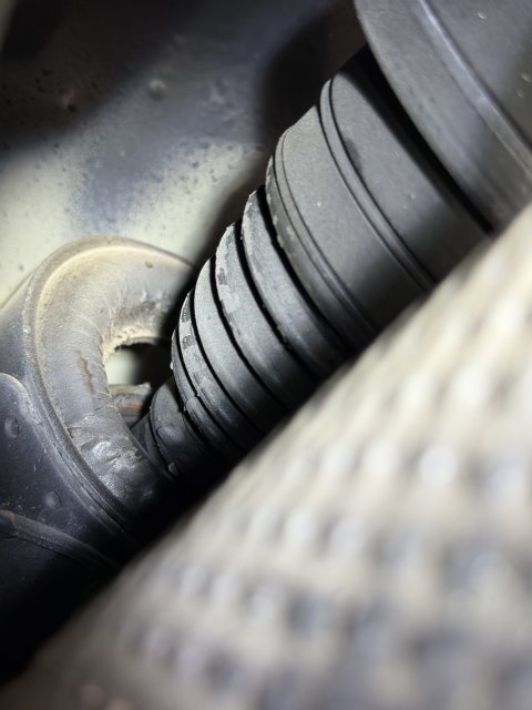

The drive shaft doesn't seem to be secured properly. We might have found the source of the friction noise. IMG_1527.jpeg

After the replacement, all the issues vanished—no more shaking, no weird noises. Now the car runs as smooth as a baby's bottom. (Btw, this part looks pretty fragile—are there any reinforced components for the drive shaft?):LOL:

Wanting to keep my car original when the drive shaft (DS) center bearing support went out on it i replaced with an original. Dodge makes you buy the entire DS and its very pricy. There are several other options, like a one piece DS in alum, carbon fiber, or steel. You can also cut away the rubber support and metal bracket then use a JXB 2 piece bracket. If mine breaks again i think that is the direction i will go. I have read good reports on his brackets, and customer support.
Wanting to keep my car original when the drive shaft (DS) center bearing support went out on it i replaced with an original. Dodge makes you buy the entire DS and its very pricy. There are several other options, like a one piece DS in alum, carbon fiber, or steel. You can also cut away the rubber support and metal bracket then use a JBX 2 piece bracket. If mine breaks again i think that is the direction i will go. I have read good reports on his brackets, and customer support.
as mentioned, JXB makes a good kit for replacement. Takes ~45 minutes to cut out the old one and bolt up the replacement [without removing the driveshaft]. A lot quicker with the driveshaft removed
