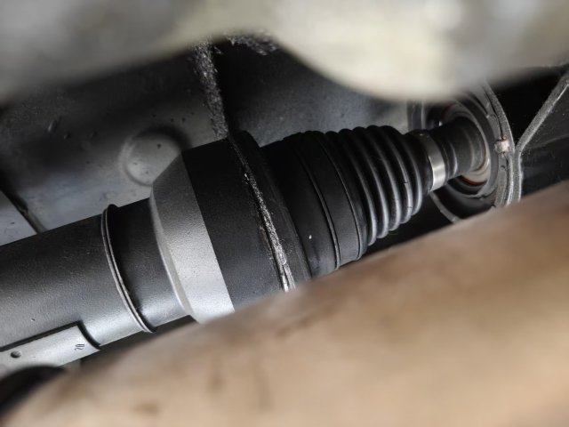

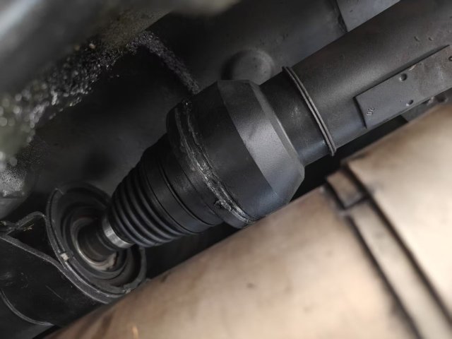

Good news: The rear boot on the driveshaft has been repaired, and we've fitted a JXB carrier‑bearing bracket.
Bad news: The driveshaft vibrates violently between 68–80 mph, and I'm not sure if that's due to the street‑spec bushings I bought being too soft. I plan to buy a set of track‑spec bushings and swap them in to see if that fixes the problem; otherwise, I'm considering replacing the entire driveshaft.[dunno]
I run the track inserts on mine. I can only feel it on take off. You probably have another issue.
