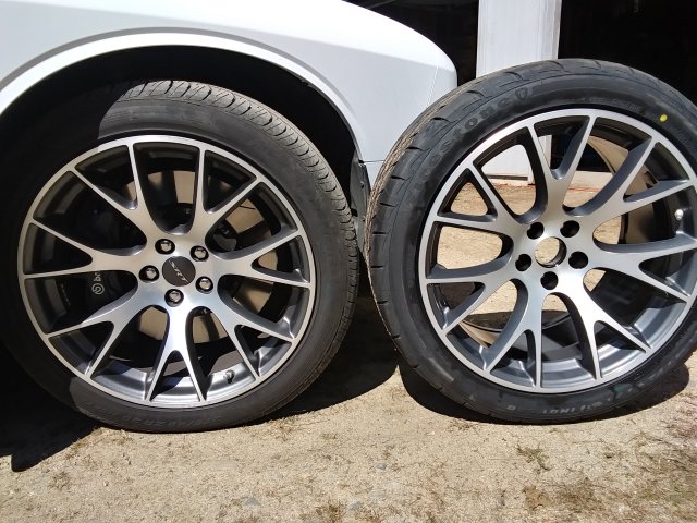

Here is what I have on both cars with 305's, except this paint config is apparently no longer available in 10.5. The pockets were black and I repainted them to gray.
https://factoryreproductions.com/pr...lcat-replica-wheels-gloss-black-machine-face/
Some of the other "slingshot" wheels are available in 10.5. I am very happy with them. You can always have a wheel repair shop refinish the wheels to match your wheels. Here is the 10.5" FR next to the OEM.

That looks really nice, 2nd.
I should probably paint my black ones gray, then sand off the paint from the spokes.
Just jack up the car and run it at about 30mph and polish off the spokes! :)
