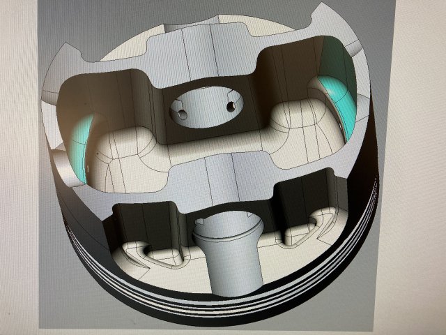

My custom designed piston, quench area matches the head chamber instead of round dish dead heading into the flat areas of the head, be good for extra HP and Tq. They will be hard anodized in the ring areas and crown, then crown coated with a reflective heat barrier, skirt moly coated, entire piston sides then over coated with a cylinder fit material to make them quiet, DLC coated .225” wall H13 tool steel pins, 1.2 1.2 2.0 mm Total Seal rings, .310” top of ring groove to top of crown, be good for 225 hp per cylinder their engineering says. Unfortunately 8 weeks out :(
069B81A4-F3D5-4E50-9A75-D3C2CA83FEE1.jpeg F8C31D9C-1640-4068-9807-775044A6C267.jpeg
