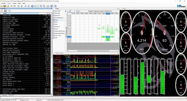

So I have experienced this twice and I thought it was just a fluke. I’m going to hook up the data logger today and see what’s going on.
4,149
10,438
Hooked up the data logger using the most recent beta version (only version that will communicate with the newest flash on GPEC2A PCM) and found some interesting tidbits. Something is borked in HP Tuners. As you can see my actual MAP sensor is correct but the PID they are monitoring is not correct. That or my flash is completely bunked. To fix this issue I created my own custom math parameter which takes the MAP hi-res pid and subtracts the BARO Pres hi-res pid. This gives me boost back. Since this is beta I don't think I should count these logs as legitimate but hey you got to piss with the cock you're given so lets give it a weeeeeeee!
Either HP Tuners is borked or I have the Space Shuttle crammed into my engine bay. I filed a bug report with HP tuners and I think all will be fixed in the next beta update. In response to @Blow By and my own issues, I could not replicate it today. I drive in Track mode with the paddle shifters to test and that's how I drove in Marylexico today... I do remember that the last time I had that issue my drive shaft was at play, I'll jack up the car and make sure the bearing bushing is still good. I'm going to throw the god damn drive shaft at FCA CEO if this thing breaks again, dart style.

HPT beta versions are typically fine, it's the change in PCM code that causing the issue. HPT will have to remap some things it seems.
4,149
10,438
Updated the beta today, all is well for now. Did some data logging today in Marylexico. Did a pull from 75 to a high number and she felt fine. Right as I hit 10 PSI the car was at 10.66:1 (13.85 x 0.77), boost peak at 11PSI the car was at 9.97:1. When I let off everything felt normal, of course when I brought the car home and shut it off it sound as if the intake was playing a butt trumpet. Still haven't been able to replicate the falling flat on its face, however I have noticed that the car is more tempermental about switching from track/sport/custom/default with those orange triangles.
