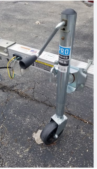

I like mine more balanced over the axles. Gives me a more stable and comfortable ride.
It's sitting on the jack.
Not sure I understand. I'm old, simple is best! :)
Balance without it sitting on the front jack. You can then tell how it's really balanced.
You don't want the ass end dragging.

Sorry, still confused. The jack was not involved in my measurements.
F150, 24ft. Look at position of car.
Same trailer. Different car and truck. Look where the rear wheels are.
6,890
12,813
That's also a heavier trailer, putting more weight on the tongue even when empty.
I agree.
Did he balance with the jack down or up?
If down he might need to move it back some since it's moved up on the axles.
