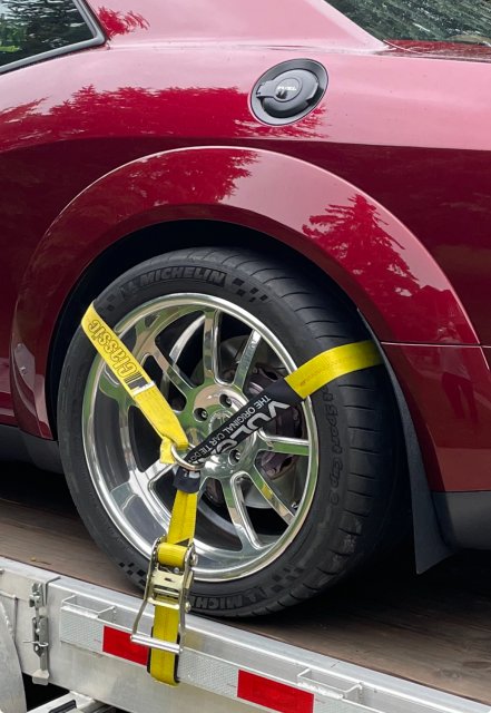

In your case, if the car is positioned correctly for tongue weight, I'd run the lasso strap to a stake pocket D-ring in the stake pocket just behind the center of the tire.
I have never run four lasso straps straight down vertically, wanting more fore and aft efficiency. And why the stake pocket D-rings? Because I only use hooks with clips, not wanting anything to possibly be able to detach.

When towing my cars with expensive suspension, we always have rings on the body, and keep my shocks from beating themselves to death. Hundreds of miles of towing = 4X the dragstrip passes on the suspension. Just how we do it with our racecars. Opinions and applications vary....

Thanks. I did a bunch or research and this was a popular setup, but my immediate reaction is the pulling down and to the side does almost nothing for F-R support. In hard braking I would expect the car to shift forward until the strap is at sufficient angle to provide rearward support. I was thinking maybe using this system and adding another strap from the D ring to the trailer rear tie down point.
