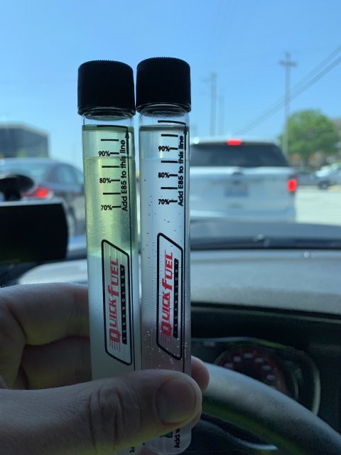

Well, I think my injectors are going to work out. Car was low on fuel (Go Man Go is much thirstier it seems LOL) so I topped up with 10 gallons of E83 measured fuel. Log read alcohol as 79 - 83%.
Made a WOT pull first to 6300 to check things out and topped out around 73% inj DC, so I made another hit up to 6500 and they never went above 75%. Fuel pump DC 77% fuel pressure 85psi. It was about 65° F aircharge was 1850+, 2.18 - 2.19 pratio, and about 17psi of boost. I figure anything below 85-90% on inj DC should be good so even in 30 degree air I doubt I'd go much higher than 80 %.
Having that extra pump behind the injectors seems to make all the difference.
So far I'm about +5 deg of add'l timing over the 93 octane tune and no STKR. Pretty crazy for $1.66 a gallon. I'm within spitting distance of what my RM109 race tune has for timing advance.
Still have more testing/tweaking to do, I wanna get the alcohol % reading to move faster if possible. I suspect there's some kind of counter that's used as an average variable in there and needs a shorter time to average readings or something. Mike@OST is working on that. Not such a big deal when adding ethanol, but you want it to react very quickly when dumping in 93 so it takes the timing back out quickly. Once we get the timing and fueling where he wants it on E85, we'll start playing with fuel mixes in small quantities to make sure things are reacting appropriately and quickly.
