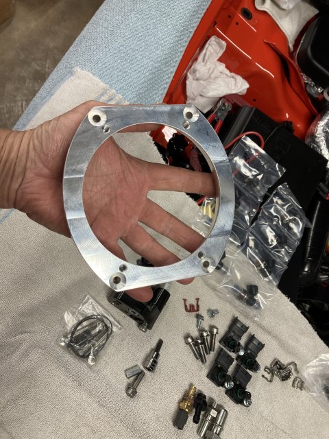

Putting the Nick Williams 112 back on. Have a specially made adapter for it.

But even the huge compared to stock TB the 112 looks puny and out of place on the huge inlet of the 3.8. I may have to go to the 130 just because of that, just doesn’t look right.
