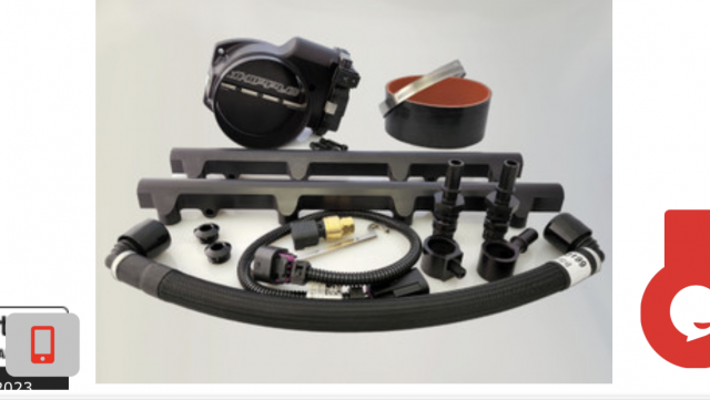

First hurdle, stock fuel rails do not fit on the 3.8, there’s no mounting points for them provided :(
Whipple cut me a GREAT deal on the Fuel Rail kit for it, THANK YOU Whipple!!

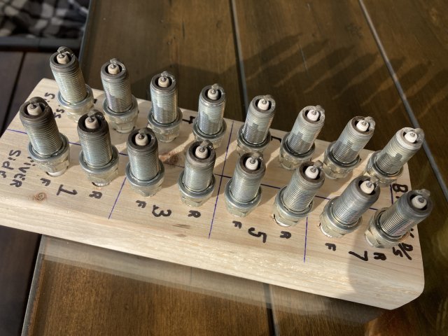

Before we get too far first need to know how engine is doing. Spark plug check and leak down test.
Spark plugs, not bad looking for about 5000 miles, these are the same plugs I started the engine up on.
For re-install Reducing gap from .023” down to .018” as planning on just a tad more boost :)
NICE kit, much nicer then Fore kits I have seen View attachment 118448
Ditch the hex head bolts for the rails. 1st time you need to take them off you will wish you did. I went with same style small head bolt you told me to use for the blower itself. I can use a ratcheting wrench now for the rails
