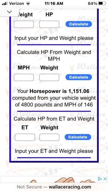

How much boost you making @16GoManGoHC2 with the 3.0 and lower 22?
22.7-8 solid 23.6 peak in 2300 DA
RE cam and JBA 1 7/8” shorty headers through cats and stock exhaust. Estimating by 145 mph 1/4 times and 5.22 60-130 times probably around 1050-1150 wheel at the moment. Was supposed to dyno today but it’s raining here all day :(
537C56BA-9AEE-4E61-9428-EA9A91EE0AA1.png 2FEE9ED0-72BE-4B33-8535-471B081B8042.png
