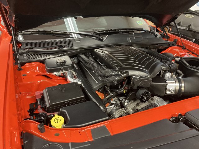

Mine’s on :)

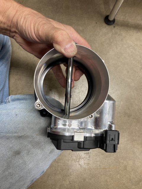

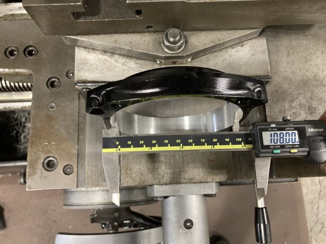

BTW, the Throttle Body (TB) adapter that comes with it may take up to a 108mm TB that has the same bolt on pattern as the stock 92mm unit but the adapter has only a 92mm inlet in it as it comes. If you want to go with a bigger TB your left to modify it on your own.

Needed some small tune tweaks so far which were quickly handled (in like 15 minutes of contact) by my tuner @jonx96 of Moored Performance (HIGHLY RECOMMEND, can’t beat the price or response time)
https://www.mooredperformance.com/
Waiting on proper blower belt which should be here today, the 7 rib temporary belt I used for sizing from autozone just not cutting it lol, starts to slip after about 3500 rpm, it’s too long to get good tension from the tensioner snd 30% to narrow.

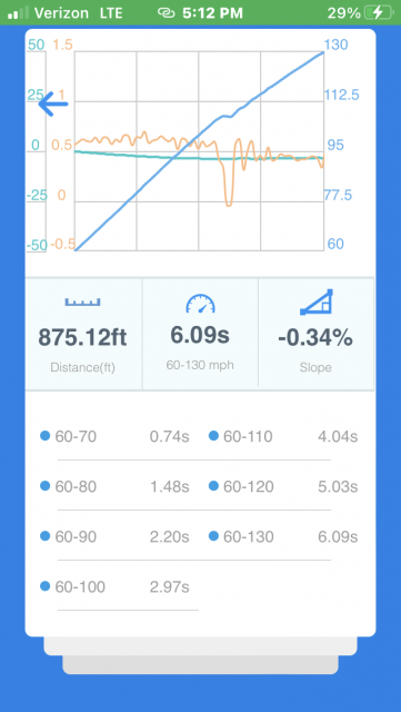

Better belt,
first 3-4 hit netted this
F73333F5-CACE-45F7-A842-065EA6BC3EEC.png D17AF947-29DB-48DA-AFB7-99B2BB112006.png
Pulled like hell up top, can feel the difference no doubt

Here’s Draggy 60-130 times over the last 2/3 weeks. That’s with a 2.4 IHI with a 2.72 up top and +10 ATI lower with a billet inlet plate, ported snout, and 105 mm TB, ie it’s at its MAX !!!
09AD3208-B90A-47BA-8286-584E1C0C4D21.jpeg 965C251C-CA42-4577-8063-34044ACF3FA8.jpeg
Compare 8/18 to today, almost exact same weather conditions temp and DA on the same bridge, 1/2 second gain, about 1/10 gained every 10 mph. And best of all??? It whines (ie SCREAMS) about just as much as the IHI did but hopefully will last much longer. Happy with the upgrade and purchase. 👍👍
