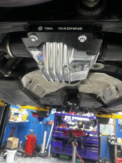

Looks nice. Think it even needs a brace?
Do they sell them complete with gears and all setup?

Yes they do
7,724
6,606
Wave track makes a carrier that’s what I put in
Ok, pretend I know zero about these rear diffs-which I don’t lol. What all is needed to put into one of these, and where do you source the parts from?
Hhp sells the carrier if you have a 3:09 diff now you can transfer the ring and pinon. And tba sells the cases seals and shims as a kit or you can buy a full rear end done from them

Just looked, you can only order the hellcat wavetrack through dusterhoff? That’s dumb
7,724
6,606
Yeah, I have a 3.70 now, need a 3.09. So need a ZF for parts still it looks like
TBA also has the wave trac in stock. TBA also has the seals shims vise holder and carrier bearing holders Easier for setting it up!

new diff is I. Sexy looking. Thanks Todd

This thing is purdy looking, kinda Jelly but I got some goodies on the way so I can't complain :)

If I end up needing this I'm having it sent to you for setup.
Way easier than a factory diff. And I would be happy to do it. Trying to make it to your Mopar fest with jon

I have never broken one. With that being said if one breaks can cause some other damages not worth it not doing it if it can take out a drive shaft or trans
I won't be able to swing it this summer...but I AM running HRDW this year. Debating how much more to shore it up before I go.
910+ whp on a 315/50/17. Pretty sure the real test is gonna be the "House of Hook"...otherwise I doubt I'll be experienced enough to launch hard enough to really endanger much. The class has a limit of 8.50 and last years winner was 8.5x...I'll be lucky to average Low 9's on an absolutely terrific weekend.

Wonder how the new D170 diffs will play in to these options? Has Direct Connection stamped right on it so have to assume they'll be an available upgrade?

I'm hoping...

@Hatermkr I had someone ask me a question about these factory diffs in these cars. Is the diff cover part of the main bearing cap or is that not even applicable on these?
The caps are part of the back half of the case. TBM machine makes bearing caps you can put on to set up rear end. That is the only way with the with out the case 100% together
