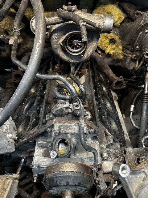

Doing head gaskets on my duramax right now that took my time. Will have buildup after truck
1,520
13,164
Walland
21 Challenger Super Stock
Oh that’s a fun job! NOT ! Although not as heavy as a Cummins head😮
Nope not fun add 401,500 miles on it
1,520
13,164
Walland
Oh lord I’ll bet you said a few swear words here and there 🤬
I try not get mad
6,910
17,828
There are some jobs I can technically do, but drop it to the shop and tell em' to call me when it's ready. That looks like one.
Book time of 43.2 hours at 150 a hour I will do it myself lol
6,910
17,828
One broken bolt away from 86.4 :LOL:
7,670
6,448
That’s nothing, my dodge dealership wants $186 an hour for labor 😅🤣🤣🤣🤣🤣
