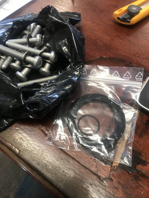

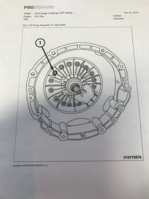

HERES THE PUMP BOLT KIT I SPOKE ABOUT THAT YOU WILL NEED IF EVER REMOVING THE PUMP BECAUSE THEY ONE TIME USE ,THERE IS ALSO A PROPER TORQUE PROCEDURE WHEN INSTALLING THEM ,
IN ORDER TO SEAT THE OIL PUMP ASSY PROPERLU TIGHTEN BOLTS 1,7 AND 9 TO6 N.M ( 53 INCH LBS) ,THEN WORKING CLOCKWISE PATTERN BEGINNING WITH NUMBER 1 TIGHTEN TO10 N.M( 89 INCH LBS ) THEN WORKING IN A CLOCK WISE PATTERN TIGHTEN AN ADDITIONAL 90 DEGREES
As you can see the bolt kit comes with new from seal and input shaft oring image.jpg 3399EE25-7961-42B1-9422-FBAA2377A468.jpeg
As you can see the bolt kit comes with new from seal and input shaft oring View attachment 7510 View attachment 7511

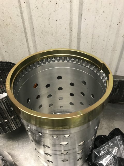

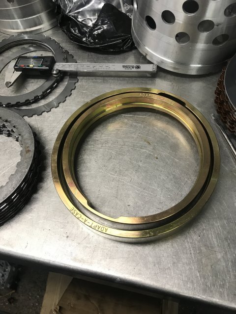

In case you tackle one of these transmissions yourself you will need theses adapt a case sleeves to remove the c d and e clutches from the aluminum shells without them you will break the shells don’t kid your self thinking you can do it with out them
Also you remove the rings a 180 degrees from the ring opening 8E502785-0599-48E3-AD3C-C4CD243C79C6.jpeg F53BA568-A60D-44B8-B9AB-BFAFF1352537.jpeg

In case you tackle one of these transmissions yourself you will need theses adapt a case sleeves to remove the c d and e clutches from the aluminum shells without them you will break the shells don’t kid your self thinking you can donut with out them
Also you remove the rings a 180 degrees from the ring opening View attachment 7514 View attachment 7515
The right tools for the right job !
