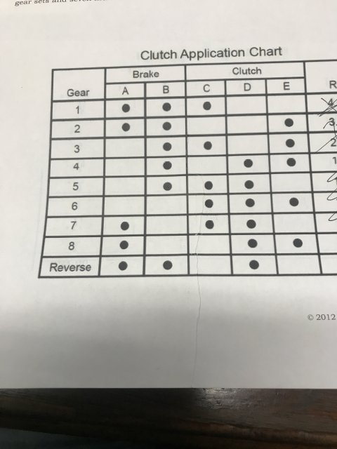

Here’s a clutch application chart that details what is applied in each gear it’s from a ZF8HP45 but it’s the same as the 70 and 90 series B9EF2F57-7F4A-4E4C-8C74-8A3A439A3E6D.jpeg

Dang dude, fast work and great info. Auto tans make me nervous and I leave that to the pros like you. I kinda understand the clutch diagram, but can you explain it? So E and D clutches were slipping and those appear to be used in just about every gear.
I had some down time at work today and dug in to some of the trans tuning stuff. There is a TON of stuff you can do in here. Admittedly a lot of it I don't understand because I'm no auto trans expert, but the two of us could probably come up with some good info.
You can definitely set shift pressure per gear as well as clutch ramp time, torque converter fill time, and a bunch of other stuff. I'm gonna look at it some more tomorrow and compare mine to a Demon crate tune and a RE stock tune.
