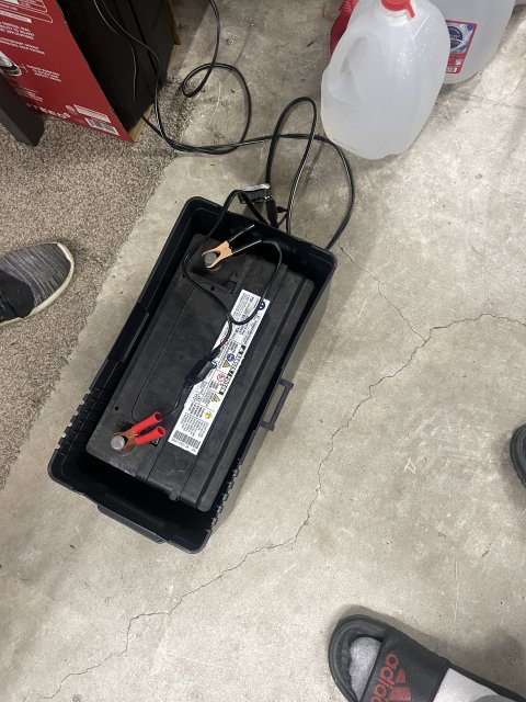

Plenty of room for a big boy battery.
5D2D5D08-7B2E-40F2-A9D9-0824E36D4ED1.jpeg 4BC6A72F-C871-4663-952A-FA7CDA64742F.jpeg
6,927
12,875
Looks good.
I'm rethinking my whole battery/cable situation. Will still need the nice jumper cables you posted earlier, but can probably fit the battery in the front toolbox.
That'll allow using much shorter cables for the winch, and then smaller gauge ones going to the hydraulic pump and compressor.
The space lost in the toolbox would partially be made up for by using the room the batteries in the under bed boxes is occupying now. Glad you got my going on this project.
