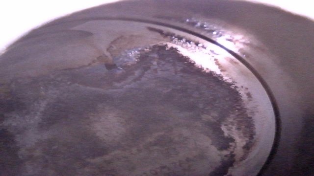

Removed the goofy ass orange valve covers. Manton Hellcovers, still have a baffle but it its not giraffe length anymore.
AAACD01A-9AD5-4FE9-B090-332A63EA92F6.jpeg 403712E6-AAAB-46E3-9A9F-3A06E3CC82E6.jpeg 273AAE9B-5CE7-4DC9-A6C0-83375A080FB9.jpeg A1FC4B39-63F4-40E6-BFE1-96AE4FF869D7.jpeg 7285691B-63D3-4BAC-8EB3-C46418A451C9.jpeg 6302AC2D-E23C-4B3E-888D-788EC9D62346.jpeg 428D07DF-5B45-42D6-BAC3-74DCADBCE870.jpeg AC7B3CA1-B078-4825-9F0D-0562C79F277B.jpeg 8F92F770-96F4-4868-8C21-D2BC5E86A5BF.jpeg
piston looks better than a year ago, e85 starting to clear the piston head off. Can see the whole serial now and its not fucking orange anymore. Do have some deposits, most likely blow bye.
full send, fuck it, still would appreciate any feedback (dont wanna hear shizz about the dirt on the pistons). Regapping plugs, putting coil in and driving it. Might turn off the misfire detection. If it goes it goes.
