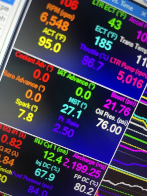

Not a problem broski. Start of pull: 62.6
End of pull: 87.8
Keep in mind air charge temps start to pull timing based on the following values in the tune:
You could move Part Throttle Ref IAT to 999 and it would never pull timing...
Didn’t you upgrade to triple pumps? Pump DC 89%, FP 79/80 psi, Or is that how it works on the control setup you’re using?
This is how it is, pump 1 is going hard but the computer don't know about 2/3
