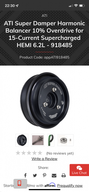

e85 is next, been studying for that tune. Would you recommend this overdrive?

Thats the one I have been running on my car.
With a 2.72 Hellraiser and the 10% overdrive, would you have a guestimate on what the size would be? I know you run a different S/C but if you had a guess?

The ATI 10% overdrive lower adds about 3psi of boost.

K100594HD i believe is the belt number for Litens 2.72 and ATI 10% lower

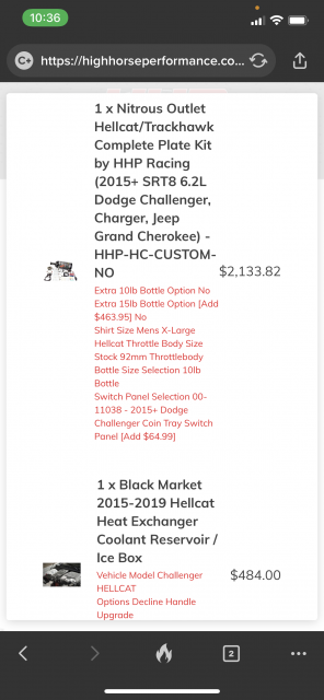

For anything over a 100 shot the professionals will be called in. Spoke with HHP about the kit and we walked through what the setup would be.
Ya problem with nos is you'd need a dyno day and a lot of nitrious to get it dialed in perfect. Then you'd prolly want another track day to get the powerband how you want. Is the goal 8s?
