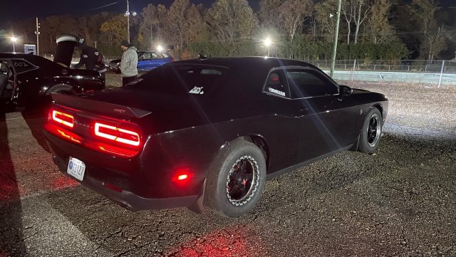

DE8230FD-0DEA-448D-8109-24A30F123CD3.jpeg The D5 fronts complete the look and the Mickey Thompsons drove beautifully.

View attachment 57783 The D5 fronts complete the look and the Mickey Thompsons drove beautifully.
How did those skinnie tires do on the street, assuming you drove to track on them ?
What tire pressure are you running in them ? strip & street ?
They drove just fine, as with even the S/R don't take turns fast and don't brake hard, with skinnies on I tend to do the speed limit more in the right lane. 50PSI as per Mickey's site to get the correct load rating. It was cold so they dropped to 44, but on the way back home tonight bumped them back to 50. What makes me happy is they have a TPMS in them so the lest shit I have to deal with my god awful Tazer the better.

Yeah I saw M/T site say 50 psi max, wasn't sure if you would run them lower than that, when driving on the road they will rise in psi but not sure how much ?
My buddy called M/T about that tire & they told him the load rating was too low for the HC weight in the front, but if they work that's good.
