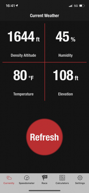

DA wasnt bad at all, however thats relative.
99304261-C276-40E5-ACD1-6CBA8F63618A.png 4E6F093B-5C23-4188-B6D0-56ED4A20F711.png B63815A8-C5FF-4BD0-AAD1-A94962886B42.png
