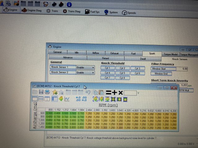

I must of missed mention of a knock issue. In any case I think 11.66 afr is a sweet spot. I always shoot for 11.4 - 11.6 for a street tune. That's .83 lambda on the Hellcats 13.85 stoich. I go for .81 on E85. I'll bring in a tick more fuel above 6000 as a safety.
More of a OCD issue then a knock issue lol. On my Flex tune I refuse to go any higher then 1.600 volts on my knock sensors. @jonx96 made this graph for me and plotted average knock. For the knock sensor settings and on straight 93 no octane boosters (no more of them for me, I’m going to splash 12 gallons of 93 with 2-3 gallons of E85 for about a E25 mix and that’s going to be my octane booster!!) and making about 825 wheel and 6.26 second 60-130 times on these timing settings on 93 I should just leave it alone lol. My mystery is why sometimes it runs totally clean STKR wise and 10 minutes later on return 1/4 pass same bridge just opposite direction I’ll see STKR. But if I do a pull in 3rd gear alone or even a 3-4 pull for a 60-130 run no STKR but in a 1/4 pass same weather conditions I get a degree or so of STKR blips. That’s what I’m trying to solve.
These are my high and low knock sensors and timing at various aircharge. I know I could bump up the knock sensors a bit but trying to find other ways to quench it. I’ve even had thoughts my stock damper I used may be some to blame and harmonics might be coming into play. Putting a stock size ATI Superdamper on now and come hood roads see if that makes any difference at all first.

IMO that's just too much timing on the 93 timing map by several degrees. I'd pull 2 deg across the board from 1.48 aircharge and above and test to see what the logs show for knock at that point.
I told him I wanted to rework both of his timing tables. The high end of his e85 is fine but the mid range could use a little work. I think there is power to be had just from reworking the tables.

I’m alway open for safe experimentation. The 93 portion is based off my original HHP tune that ran for 2 years on 93. I’ll find and post that timing map for comparison, it’s scaled only to 1.50 aircharge with 14 degrees of timing, so that meant everything above 1.50 aircharge got the same timing curve as 1.50 right? That’s why I scaled it to 1.90 aircharge and reduced timing in higher boost

1.50g aircharge and 1.90g+ are different animals. You're seeing some STKR (not bad but still) in your log so first step is to back timing off to see if it goes away.

I agree, what I’m asking there is if a tune is only scaled to 1.50 aircharge and the aircharge exceed that scaling and is actually 1.90 the tune will still follow the 1.50 aircharge timing table or no?
I just adjusted the next tune I’ll run on by this amount
So looks like this now, that is the areas STKR was blipping up in the 1/4 pull log.

That was scaled way wrong for a 2.85. You’ll see 1.7 with a 2.85. That’s your stock timing scale

How’s this look? I took everything under 1.5 aircharge and copied it over into the appropriate rows
