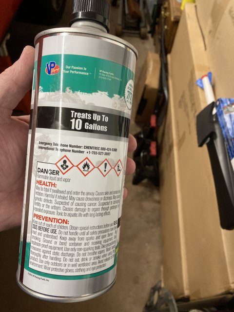

Has anyone used the VP fuel cleaner after/octanium?
VP Octanium Unleaded: VP Racing Octane Booster | VP Racing Fuels, Inc
Will Octanium® Unleaded leave orange deposits on my spark plugs? Will I have to change my plugs sooner?
In a word, maybe. Octanium Unleaded may cause orange deposits on spark plugs as a result of its high concentration of MMT. As a result, we would recommend adding VP Fuel Cleaner with RP21, which is formulated to clean and restore engine components. In addition, you can also blend Octanium Unleaded with gasoline at specific ratios, which will add even more protection for emission control devices (see chart above).
