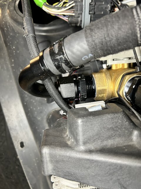

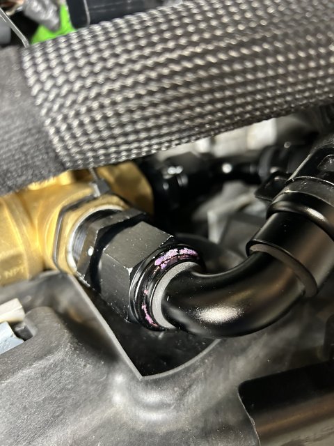

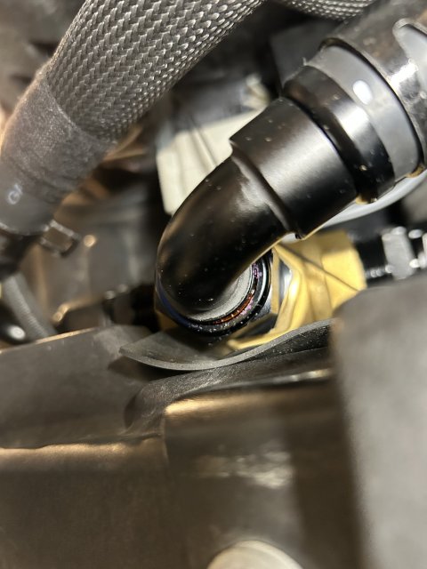

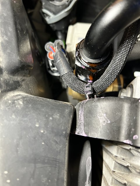

Dang it. Too loose? Hand tight then snugged tight using two 8" wrenches. Or just bad ones from Amazon?

Hand snug then 1/4 turn. Both mating surfaces need to be perfectly clean.
View attachment 173667 View attachment 173668 View attachment 173669 View attachment 173670
AN fittings are a lot more temperamental than most people think. You are trying to get it to seal with just metal on metal. Always make sure the surfaces are clean and spread a little new motor oil on the flare before assembling. It's good to start out snugging them up and applying some force. If there is a leak, you can go tighter. For -12AN, you can actually go to 40 ft/lbs. To do this accurately, use a torque wrench with a crow's foot clocked at 90 degrees to the wrench handle. (There are tutorials for this.) I have had to go to 40 to get something to stop leaking before.
That being said, all AN fittings are not created equal. I have used Amazon ones that would NEVER form a leak proof seal. I like RaceFlux for quality without an insane price. I have never had an issue with one of their fittings. Plus, they do some clever stuff here and there. Like, their caps have the flare but include an O-ring for added backup. Good luck man!

None of my raceflux AN fittings have leaked. I only have a few from Earl's but they seem to be of good quality also.

This is with vibrant fittings, so not cheap ones.

I'll never use AN fittings ever again for coolant

Thread Starter #420
