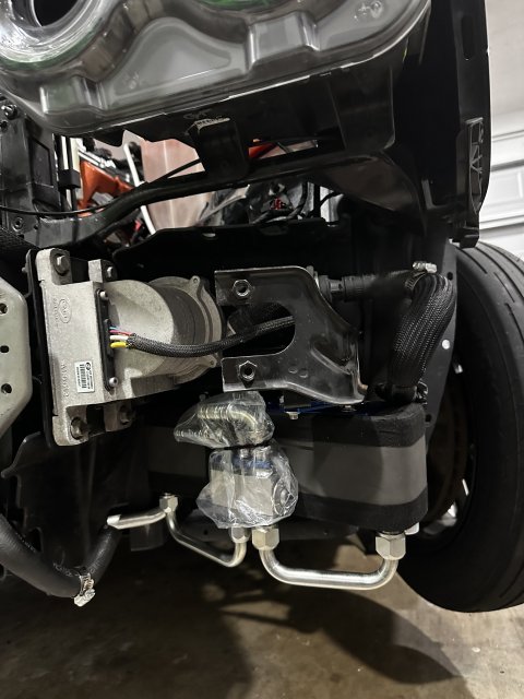

Thread Starter #16
5,498
4,529
Thread Starter #17
Getting mocked up. If you already drilled out the spot welds on your crash beam (like I did) I recommend pulling it completely, makes life a lot easier
