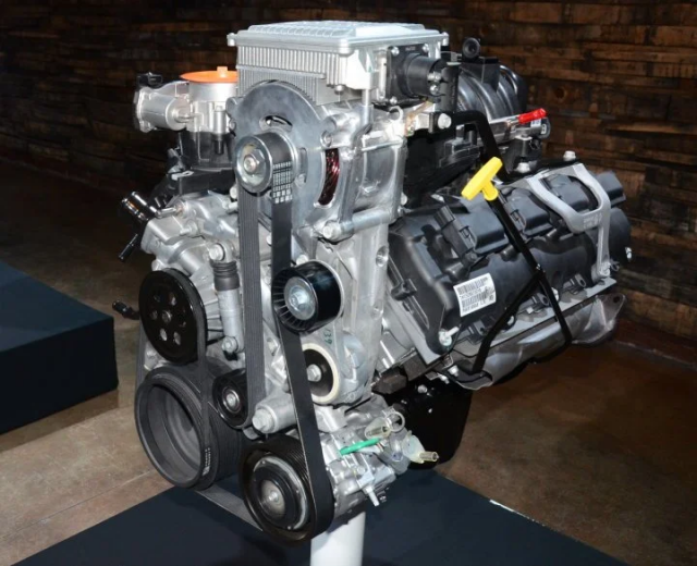

It's a chunky looking electric motor they mount above the timing cover on the driver side that is in loop with the accessory belt to add more torque into the system.
You can google image search 'ram etorque' and see what it looks like. kinda fugly.

You can see that the bracket covers 3 of the coil packs... and accessing the bottom bolt requires going in through the wheel well and everything that entails...

It doubles as the alternator, and draws off a 48V battery system when engaged.

Just like a tesla motor--either putting power out (motor), or taking power in like a generator/alternator (regenerative braking mode).

Yes. Via the accessory belt.

Google says on the 5.7 the etorque adds 130 ft-lbs... and that's through the 6-rib accessory belt. Wonder what that does to the bearing life on all the accessory pulleys.
