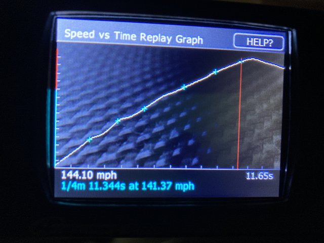

1940 aircharge...at what rpm? Thats.....a lot lol
Yea, a little blending and smoothing inside the blower along with a ported inlet plate, snout and FM 95mm TB work well together on a 2.85 Hellraiser. A bit more tuning next spring and I’m sure it will put down 950 but I’m getting close to running out of fuel, may have to add a BAP or just call it enough especially if I don’t upgrade the bottom end this winter. I’m pretty happy with the results.

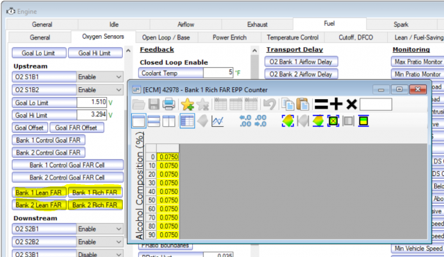

Spent some down time during the holidays to play with my flex fuel tune a bit. I'm still seeing positive fuel trims, so it must be expected for my model year. I'm seeing some items in my tune, as well as a stock 2016 Hellcat tune, that are modified to understand ethanol in 2018 and don't exist in 2019, and 2020 stock tunes I have that I think impact the trims.
These variables are in the stock 2016 Hellcat tune and not in 2019 and 2020. In the 2018 tune I have it's a table with ethanol % down the side rather than a fixed numeric like below.
I've now gotten my alcohol calcs to within 8-10% on Shell 93 consistently, I tested 4 times. On ethanol they're within 2%. I'm finding the sweet spot for me is in the E70 to E75 range to get max power and reduce the pressure on the fuel system in this cool air.

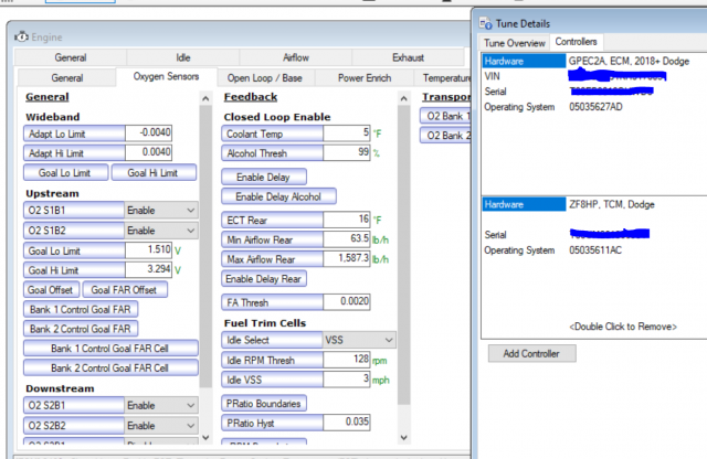

5ABC03B2-686F-4374-9AC9-C1816540FCE5.jpeg Those are the areas my tuner played with to dial in the E% as well, I’m 2016 also with a tune based on a 2017 or 18 previous tune the tuner used as a base it looks like??
I’m talking with Rick at Tapped about fuel pressure 81 psi at 94 commanded and 89% Pump DC and injector duty cycle ID1050X’s 85-86% on 85% E at 35 F ambient in minus 1000 DA 1950 Air Charge his opinion was the stock fuel pressure sending unit is restricting fuel volume to the rails. He suggested bigger injectors OR upgrade the fuel rails to Fore Rails with the center feed and new style pressure sensor with its Tee’d into the connection not pass through like the stock sensor is. He said fuel pressure would most likely not increase more then 1-3 psi but injector DC may gain 5-10% up top because there’s less pressure loss in the rails at the injector inlet verse stock setup. So the choice was upgrade to ID 1300’s or FIC1200’s and retune or try the rail theory. Since I just got this tune pretty dialed in I hate to start over in the spring with new injectors and I came across a Fore Rail set up with center Feed and lines and the sensor at a great price I’m going to try that route out and see if Ricks theory nets anything. If I could gain back 5-10% injector DC snd get down to 75% Inj DC at the same DA I was seeing 85% Inj DC I’ll be golden with the present setup for all of next season at least. I’ve been running 85% E for the past 2 weeks and the car hasn’t recalculated any other number then 85% with 3 fills now. Upon fill is goes up and down 83-87 % but settles right back to 85% in less then 10 miles and stays there. I ran a street 1/4 the other night which netted almost 142 mph in the 1/4 so I know it’s making good power now and pretty consistent following DA. Minus 1000 DA I get 141-142 1/4’s, -250 to +250 I see 139, 600-1000 DA I see 137-138, and 1500-2000 DA I see 136-137 1/4’s. Injector DC varies from 85-86% at minus 1000 DA to 78-80 at 2000 DA, I see corresponding Pr and Air Charge as well with the changing DA. It’s amazing how much more power is made as the DA gets deep negative. If only traction was there when it gets 35-40F out to make that DA currently where I live. I ran about 30 1/4’s in the past 3 weeks or so logging the changes and times with varying DA.
Some of those values sound vaguely familiar to me. I will have to check and see what I have in my 18 FF tune.

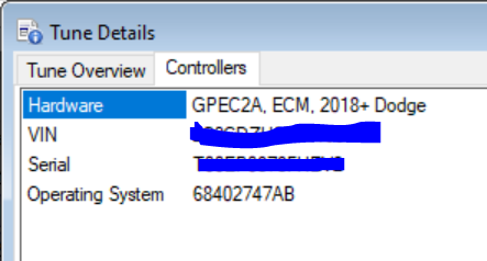

Which table were you peeking at in the 18 tune? I want to say I remember a table with ethanol percent down the side and what the appropriate FAR would be for the given percentage?
Odd that it would be in the carte PCM but not the locked factory. Wonder which OS it is?

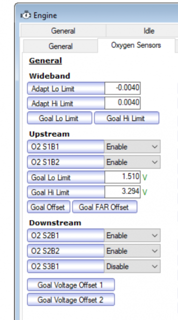

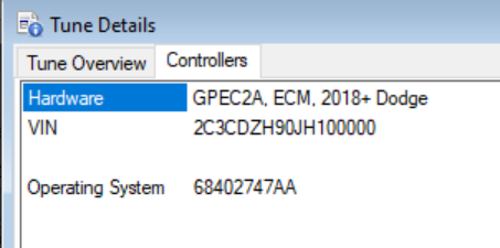

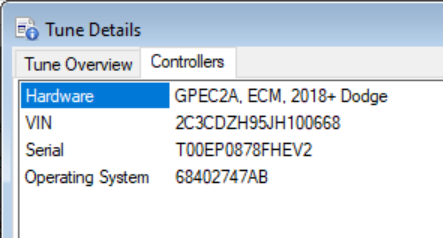

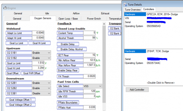

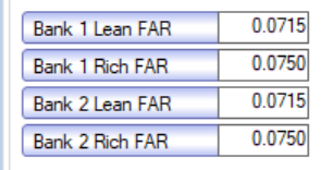

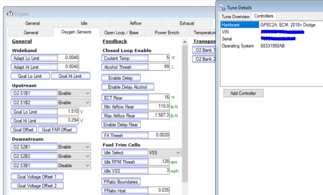

Here's more detail on the differences I'm seeing:
This is the info from a Demon standard PCM. Notice no reference to Rich/Lean for O2 settings. This could have been because HPT hadn't mapped some items yet or something though.
This is from the Demon CRATE PCM. Notice the table for Rich/Lean:
From a 2019 Red Eye factory tune, doesn't exist at least under the O2 section where it was in 2018.
Finally, a 2020 Red Eye which has about half the values under O2 section. No idea why, again could be HPT hasn't mapped them dunno.
