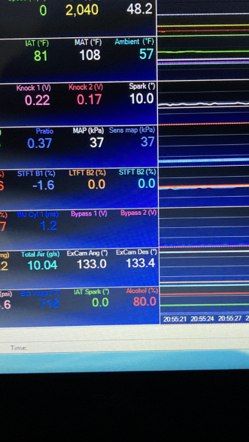

Car seems to be calculating E% better. Been mixing in 99% E and it’s reacted pretty appropriately with each addition.
Was at 77% added 5 gal of 99 to 13 gallons and went to 80%. Added 5 gallons again last night which took it right up into the filler neck and now reading 84%. Garage party tonight at my buddies Dyno shop, pretty much the same timing map as prior run, I’d be happy if she made 925 HP again and 800 tq this time with more E. Hell, I’ll be happy to just drive her home afterwards!! 🤞

Quick question to those running flex fuel. When running ethanol fuel are your fuel trims positive? On mine with the flex fuel tune installed when I run 93 my fuel trims are within +/- like 3-5% give or take. As ethanol is added the fuel trims start to go positive and the alcohol content in the log rises. On full E85 the trims are like +25(ish)%. Ya'lls work the same?
I'm assuming that's how the car knows how much ethanol is in the fuel, as the trims go positive it increases fueling through the alcohol multi tables the proper amount, but the trims remain positive since there isn't a separate injector scale table for ethanol.
Where at in your rpm/aircharge range?
Idle and cruise mine settles around +/_ 3% but WOT it will go up to 20-30% . Positive . I ran out of time to fine tune it .

I hadn't reloaded a gasoline only tune in many weeks and my logs cruising around showed +10ish % STFT and +6%ish LTFT. WOT was almost +30% STFT and 0% LTFT.
Must be working as expected. I thought maybe my trims were off.
Except during a full reset, going to a 93 tune to set E% back to zero to which start up trims on a tank full of 80%E my trims go to 30% for a short time but as sensed E% starts going up in minutes the trims fall and fall to they get around 2-3%. They then are most always around +/- 2-3% no matter the E% or 93. Like there’s a table or multiplier based on E% what the fueling should be?
Mine is very similar that it will adjust the fuel on ethonal to about 3% +/- then it stop calculating there . But that's for idle and cruise only . There is a table in the tune that says at 3% you are good . I'm just not sure where that table is ......... Yet . . But in reality 3% +/- is pretty darn good in my opinion. WOT is different. I'm still working on that . Too bad I ran out of time .

I can log trims and lambda and can tell based on behavior if learning has been triggered.
During this period the trims will cycle either to the positive or negative side for a predetermined amount of time and the pattern is very distinct.. instead of switching they'll "box out" opposite of each other for a little bit.. etc...and they'll be slightly excessively positive or negative...
I do not recall any time where after this has occurred and percentage is learned that my trims ever fell out of a "normal" range at either cruise or WOT on full E85. Sometimes depending on conditions they're well under 5%.

I've sent Mike an email to see if it's expected. Mine's done the + fuel trim thing for almost a year since we started working on flex.
I'm trying to think of how the car would know the ethanol content if the trims weren't positive. In my logs I see the closer it gets to 93 the less the trims are, the more ethanol in the fuel the more positive the trims are. It remains at this state after the calculation is complete. There are events that cause a recalc, one is adding fuel to the tank for sure. The other I think has to do with how long it's been since the car has been driven but I'm not 100% on that one, and there's one for when the fuel level gets low as well, presumably expecting a fillup.

I went ahead and reviewed some logs I kept.
At various ethanol content levels the trims are indeed positive but as long as the car sensed ethanol at the high end of 10% the STFT at WOT didnt appear to get any worse than +8% give or take.
When the ethanol was within 5-8% the STFT were about the same. Usually less than 5 or 6%
On E85 only they were +/-3% STFT.
Too many screencaps to save & upload...but I'm not seeing anything super wild like you are.

Hmmm, I'll have to see what Mike says then. I reviewed a ton of data logs and my trims are almost always positive on ethanol. There are only a few tables that control fueling and mine calculate out correctly so maybe there one I don't know about that impacts the trims.

Mine reads on the low side too much too often for my liking. How does one get it to read higher? It’s like 5-8% low at times. No biggie if it’s 85 in the tank and it reads 77 but now with ethanol dropping in my area to 75 if the car reads that as 65-68 it’s going to back off on timing too much for my liking.
There a table to adjust that??

In my testing it seemed the fuel trims affected ethanol content calcs more than anything, however anything above about E60 you're going to get a good amount of timing. I'd rather it read low than high personally. Even E60 is like 97+ octane.
