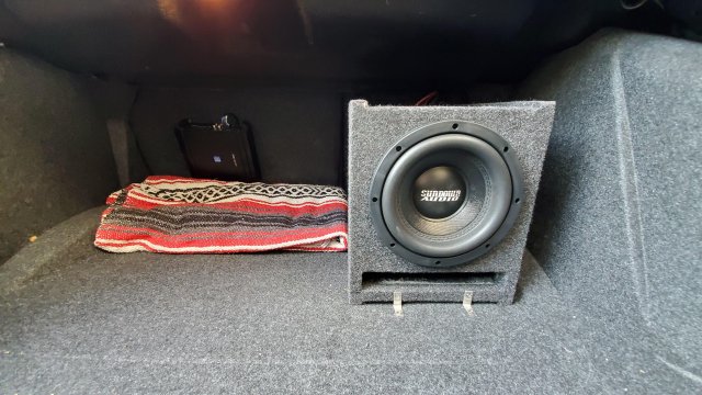

I have been very happy with this install. I've got probably 10 hours or so in the car with this JL sub and have had no issues. No cooling problems so far with two hour stretches of moderate bass play. I've dialed my input sensitivity down to about 50% for nice bass but not overpowering amounts. I can now enjoy listening to music! Sounds like it should and much more like I would have expected from a nearly $2k upgraded audio option. Plenty of bass gets through to my ears so I don't plan on cutting holes in the tire well cover or removing the unused factory woofer in the center of the parcel shelf. Bass is just how I like it, clean and tight with no distortion. No rattles from the car and not overpowering. If you want more bass, it can do a lot more, its just a quick adjustment to the input sensitivity. I'm also happy that the head unit equalizer bass slider does have a decent effect on the subs output. So you can get a bit more or a bit less bass easily while driving.

Longer term update:
Your install looks very clean and I would be interested in copying it. Quick question. Is your amp under the speaker box? If so would it be possible to get a pic of the inside of our foam tire well without speaker box? Any help would greatly be appreciated!

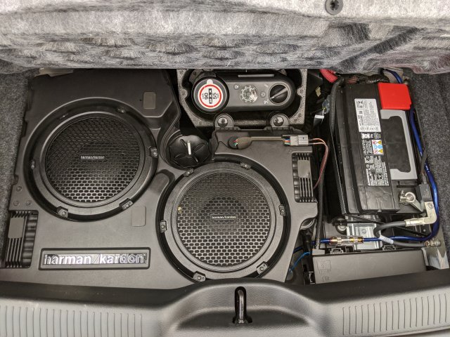

Another option is to find a slightly used Harmon sub box from another Challenger and an amp. Keeps it hidden and provides good bass from what I can only describe as baby sized magnets. About 4 years in and still sounds great. Many thanks to Diboblo again for his expertise!

Taxinator, Hello,
Yeah that Harman Kardon dual 10 box is an ultimate clean OEM set up and thats actually the direction I started to head with until recently the companies who have really nice used HK units want an arm and leg in $$ for them now. You combine that price, an amp etc and then if you ended up having to upgrade the speakers as these now older units come without any warranty and the price point is on up there. I priced a new one and with shipping and tax you'd be at around $900 plus and also the amp cost. The JL Audio ACS110LG-TW1 with built in 400 watt amp, two year warranty and good review changed my mind.
Hopefully will have it installed and up and running soon. Once complete and tuned I'll post pictures and my evaluation for you guys. Thanks again for all the input!
