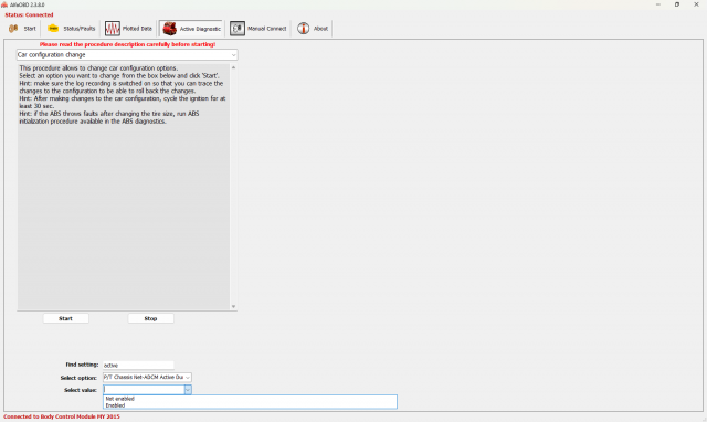

First, DO NOT HAVE ANYTHING OTHER THAN THE BLUETOOTH MX+ OR SIMILAR DONGLE ATTACHED.
Second, make a backup, connect...
Head to Active Diagnostics and then selected Backup Vehicle Configuration to file
30 seconds later:
Now... YOU ARE READY TO FUCK SHIT UP ...
4,062
10,147
How do you disable suspension and tps ?
Have not tried these myself but maybe these are the settings you are looking for...
I think it's a typo in the software"Active Dumping" vs Active Dampening Control Module... give that a shot.
For TPMS
let me know if these work for you...
so the micropod is cracked in half, makes me very sad... the tazer though is still foobar'd. Says it's married but when I connect to car it's like who are you????
