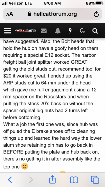

How much (longer than stock) bolt length?
Here you go, 64mm under the head

Still didn’t find where I wrote down a dimension, spent hours so far looking in the shop and in past posts and pictures, wtf did I do with the note????
Any ways, I found these pictures, 65 mm under the head more like it as I cut the bottom gold colored ARP stud down to fit and remember in my lathe cutting the round top off and about 5 threads off. I’ll measure a stock stud and add 12 mm to it and see what that number is. View attachment 12386 View attachment 12387 View attachment 12388 View attachment 12389
On my 16, I had 3/4 inch pass thru spacers. Used 1 inch longer than stock ARP.
