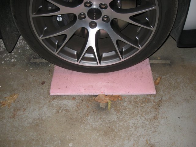

The easy solution to flat spots is get some 1/2" thick pink foam sheet insulation and cut squares to park on.
