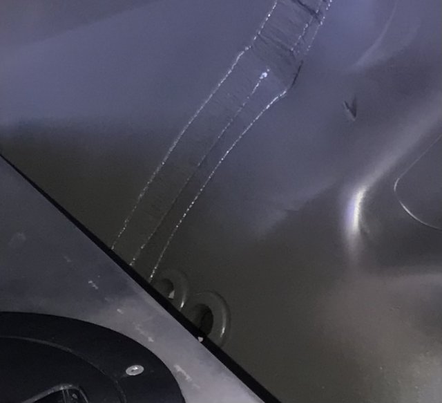

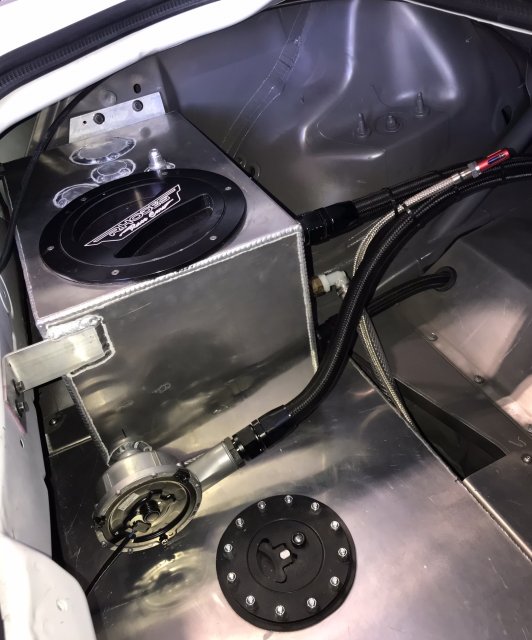

I don’t have a good picture but possibly these will help. I’m not using them now but you can see the two grommeted holes in the fender well behind the new ice box I’m using now. Those were used when I had that side mounted PNR. D67A15C8-C402-4FD8-B714-B3BBAAF104BD.jpeg C7F5DA71-AB43-4027-A5C4-119229C6086E.jpeg

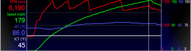

Here's a chart of my IAT's (blue line) on one of my passes this year. This was with a 3.8L Whipple making 24-26 psi, ambient was 82F, no nitrous.
ICT 45F (didn't change until after the pass)
Starting IAT 72F
Peak IAT 90F just over 6 seconds into the run
End IAT 86F
For MAT, it calculates about 20 degrees higher than IAT at these lower temps with ending MAT at 104F.
I use a 7 gallon ice tank with a EWP150 on the tank and the factory pump up front.
