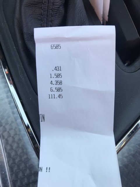

New personal best I changed the tune and fixed the 60ft issue surprisingly it hooked today on no prep
Maybe next pass will help me get a 6.2 time only using the 3.10 pulley E4AC6601-9536-459C-8450-EFEC7A4A9D63.jpeg

I won the round against a mustang on slicks I spun but stayed in it and drove around him lol 5941EFFD-482A-4BC2-AB42-A029083178A2.jpeg

See comment below

That’s a .500 light in a pro tree

That B is Rollen !
Must be a hell of a tail wind , lol. :LOL:

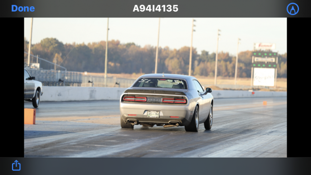

You can see how the car actually gets a little sideways on the launch 84C1DD3C-73AA-4798-9CFD-EA6F3DB424F6.png 943D3C0F-AE19-4F4C-8D93-CA55879AADBA.png
